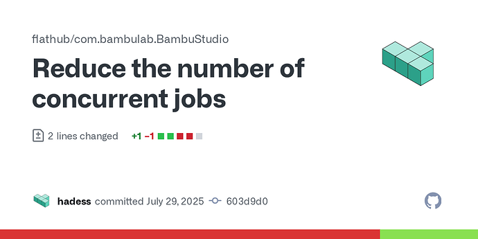

The issue was the runner running out of memory, I’ve cut down on the number of concurrent CPUs, which lowered the memory usage sufficiently for the build to go through.
H
Replying to #2
This was the work-around:
