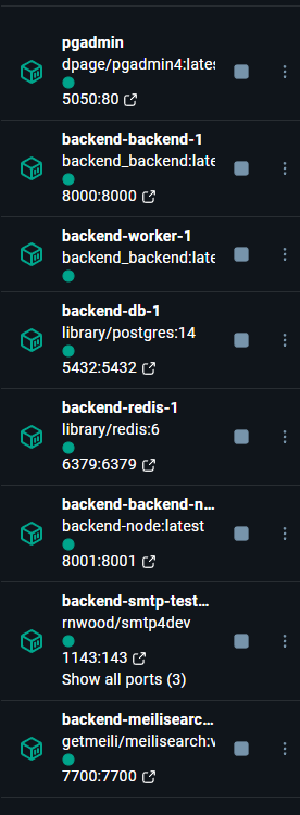

Here is the log from docker: 2025-01-13 18:58:12 backend-1 | INFO [alembic.runtime.migration] Cont - Pastebin.com
Everything is running in docker:
B
2025-01-19 17:24:00 backend-1           | sqlalchemy.exc.OperationalError: (psycopg2.OperationalError) could not translate host name "db" to address: Name or service not known
This is the problem. The backend service won’t work without the database. When everything works fine, db would be resolvable DNS name as is. What app is this? Is this docker or podman?
O
Replying to #6
Running docker on win 11
