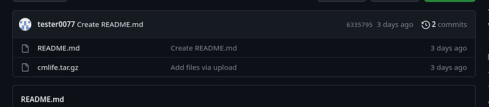

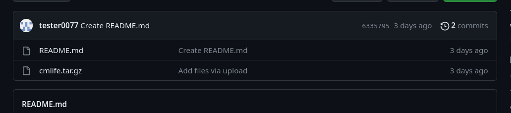

Looking at your repo via GitHub - tester0077/flcmlife: Test code for flatpak creation of the wxWidgets Life demo using Cmake-Ninja build for linux it seems like there only is a .tar.gz file, which I don’t think is something that cmake should/would pick up on it’s own. Maybe you did add this by mistake.
G
Replying to #25
Not by mistake but by ignorance :wink:
Can you please tell me what other file(s ) I need to add?
Is there a way to get a more detailed debug output or is there a more verbose log I might find and look through?
I tried the -v flag for the builder. but it does not seem to improve the data available for analysis by much :frowning:
R
Replying to #26
not really a cmake guy, but I would have thought that you need a CMakeLists.txt Writing CMakeLists Files — Mastering CMake
And an archive is probably not really helpful without unarchiving it, but you might be doing that in your manifest

When I download the archive directly I can find the CMakeLists.txt file in the root.
Evidently, Flatpak Builder either fails in the download, the unpacking, or looks in a different place but I don’t know enough to find out where the unpacking happens, if it happens.
Since there are no clear error messages to confirm or exclude any such errors, I am totally lost.
R
Replying to #28
I don’t think it unarchives.
Usually, you don’t upload zip files to git repositories. So type git just pull that repo and does nothing with it, but the build system will try to find a cmake file, which isn’t there.
Youc could use type:archive and directly link the url to your github file, but not sure that’s better. I would prefer just pushing the unarchived contents into the git repo.
H
Replying to #28
There is no CMakefile.txt there
