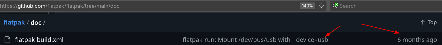

But what I see from github flatpak’s documentation:
This “–device=usb” was added to documentation 6 months ago. I assume at the same time this new feature was added.
