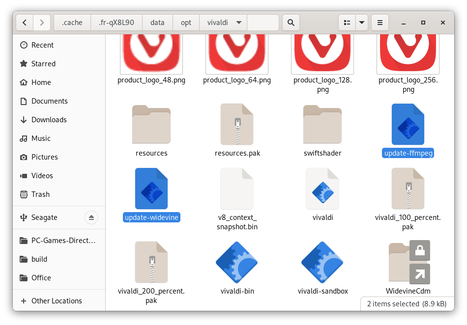

F
Replying to #3
There’s update-widevine and update-ffmpeg scripts in the .deb file. We need to change paths. when run with --user it installs to
if [ "x${1-}" = "x--user" ]; then
  WIDEVINE_INSTALL_DIR="$HOME/.local/lib/vivaldi/WidevineCdm"
Either you can run the script when vivaldi is run using wrapper script, or download the .so files and include them in the flatpak.
