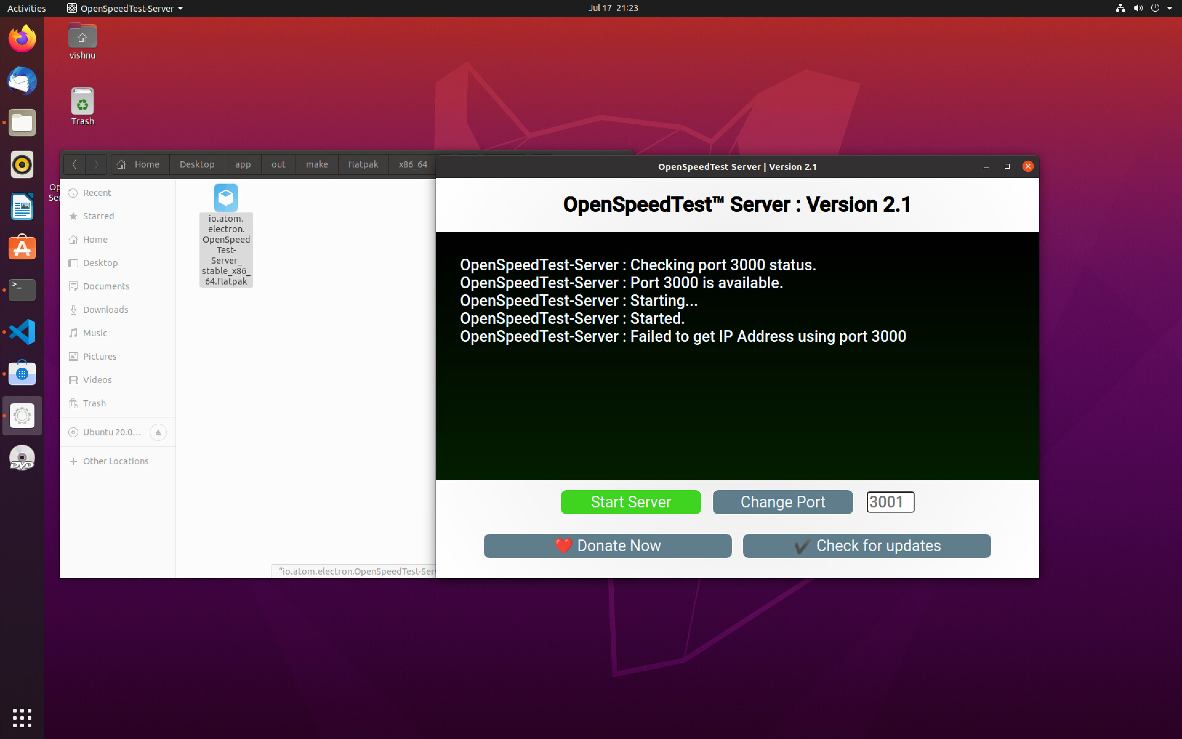

1) When i Export the same in Flatpak, Application unable to get the client device ip address.
2) Also i am not able to put a custom icon for my Flatpak.

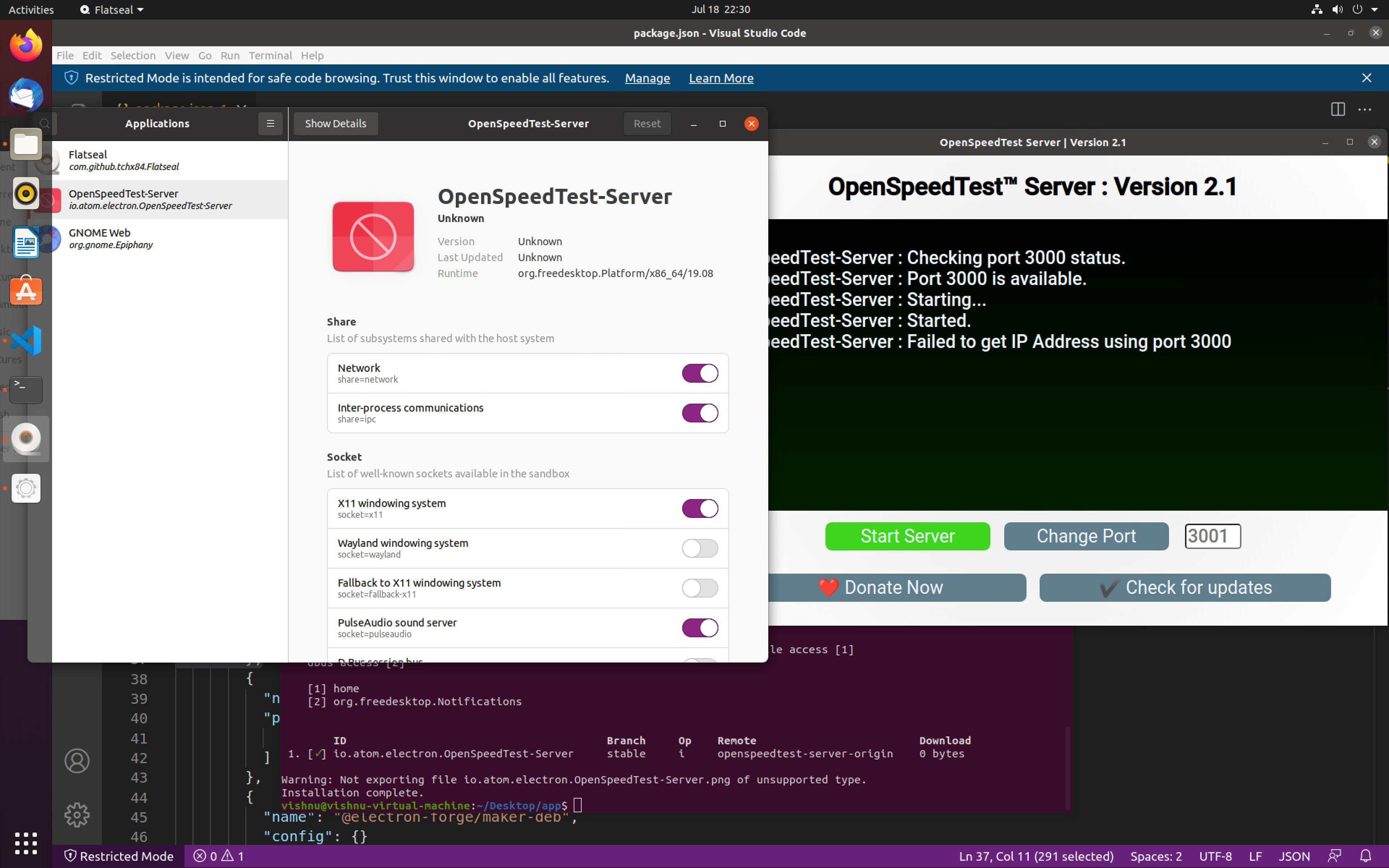

O
Replying to #4
I Install using the following command
sudo flatpak install /myFlatpak
It is getting installed. But when i open the app it is showing like the image i posted. No ip address.
also app have no custom icon.

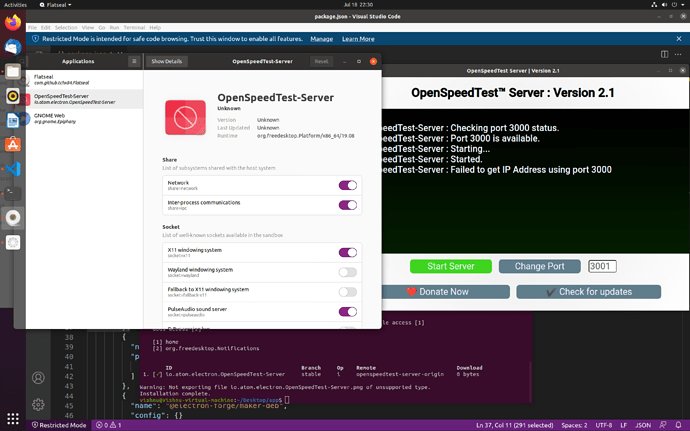

O
