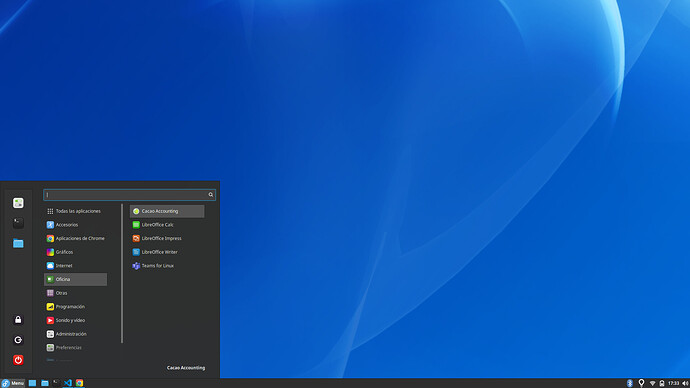

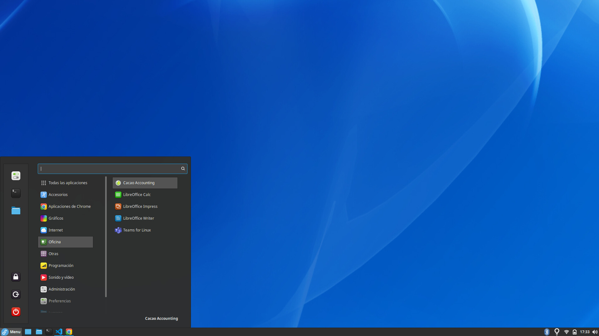

After adding the rename icon option this command work one time:
flatpak-builder --user --install --force-clean build-dir com.cacaoaccounting.CacaoAccounting.yml
And I was able to even install the app
