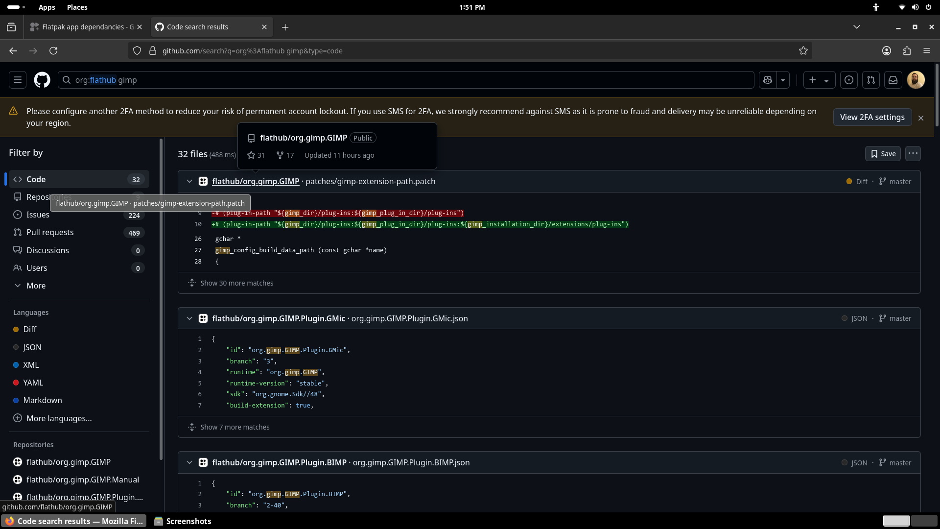

  1. Go to Flathub · GitHub
  2. Click on the search bar at the top right of the page, and type in Gimp or whatever app you want to check.
  3. Gimp in particular has a lot of plugin repositories at flathub separate from the app itself. The one I highlighted in the screenshot is the app. See how it has a part that says “org.gimp.GIMP”? That is the APP_ID mentioned in an earlier answer. Click on it at github.

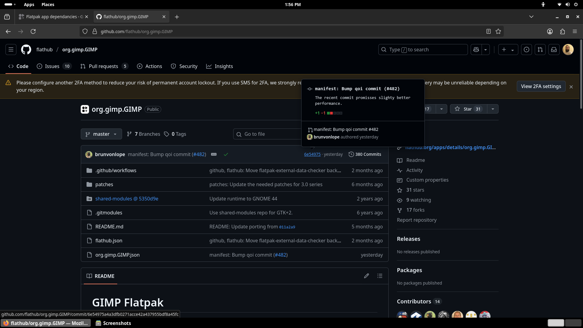

  4. This is the Gimp repository for Flathub. GitHub - flathub/org.gimp.GIMP I will attach a screenshot.
    Do you see that grey number combo in front of “yesterday” some clock symbol, and “380 Commits”? If you put your mouse pointer on it, you get a popup like in the screenshot. Click on the number.

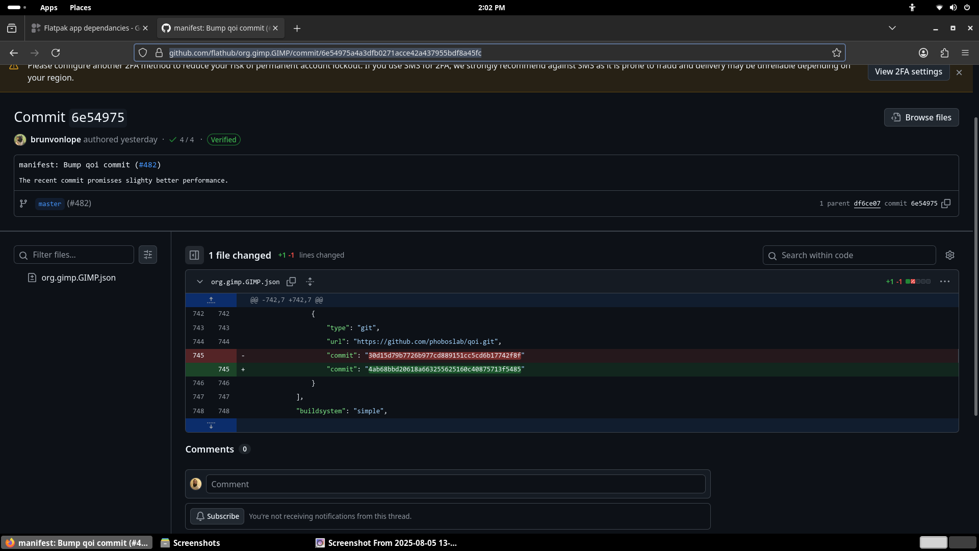

  5. This is one of the commit manifests you were supposed to look at. manifest: Bump qoi commit (#482) · flathub/org.gimp.GIMP@6e54975 · GitHub
    You can see the old code in red and the new code in green. This manifest is in .json format. I don’t understand json well, and so I use the other .yml format for manifests myself. But this shows that a dependency named qoi got updated in yesterday’s Gimp flatpak update.

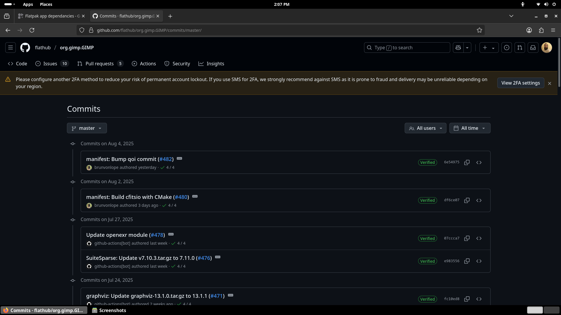

If you go back to step 4 and click on the “380 Commits” it will show you every single update that the Gimp team has made for the Gimp flatpak. Here is what the page looks like
You can see that Gimp frequently updates dependencies. On Aug 2, the Gimp flatpak update was due to the Gimp maintainers changing how a dependency got added to the Gimp flatpak. It looks like the Gimp maintainers might use an automated update script. You can expect frequent dependency updates from the Gimp flatpak.
