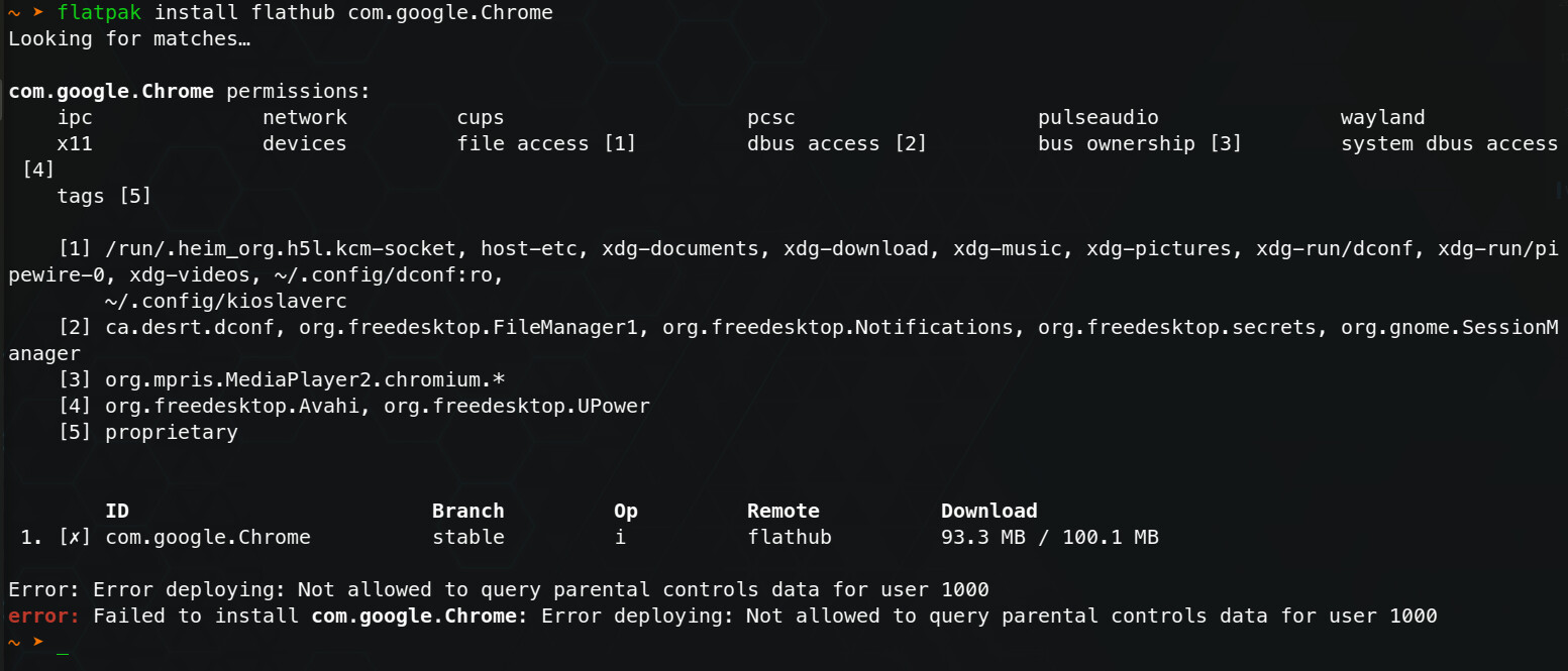

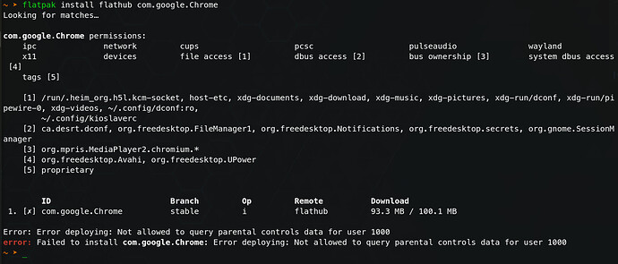

I am facing the same problem, on Fedora 37.
Some apps (OBS Studio, Obsidian, Chrome, Kotatogram Desktop) were working, but others (Brave, Flatseal) stopped working.
So I decided to: Uninstall all the apps → Uninstall flatpak using dnf → Reinstall flatpak and add flathub remote → Try installing Google Chrome from flathub
And now other apps also fail installing with the same error.
