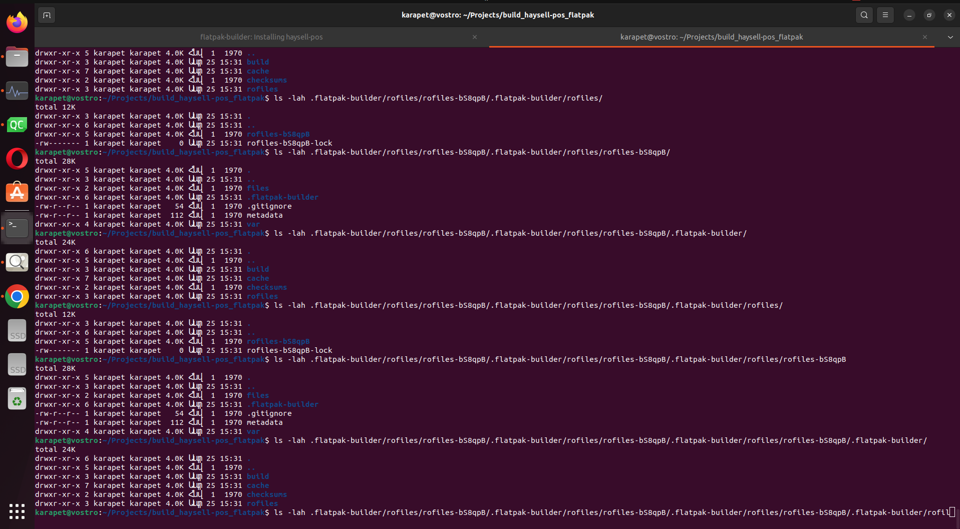

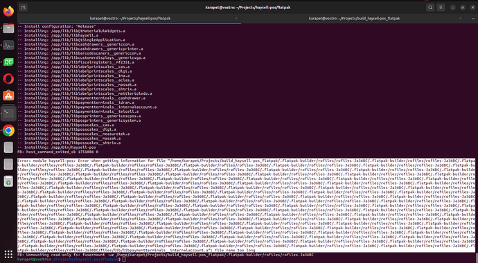

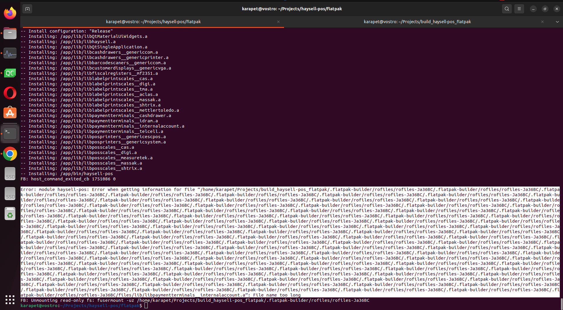

D
bellow is screenshot of error
System - Ubuntu 22.04
Flatpak 1.12.7
flatpak-builder 1.4.1
D
Can anybody explain what is the purpose of “rofiles” and why their file structure repeated recursively?
Is it Ok? maybe I need some other Filesystem (XFS for example ) to be able handle such long file names ?
