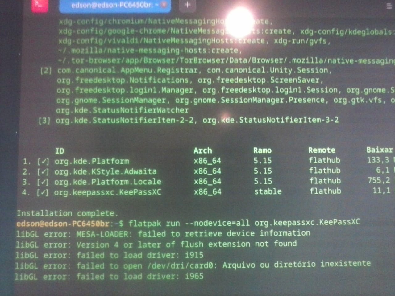

Below is an image containing the error presented.
Unfortunately, with the command requested, it also crashed everything and it was necessary to restart the machine with the button shutdown manually.
