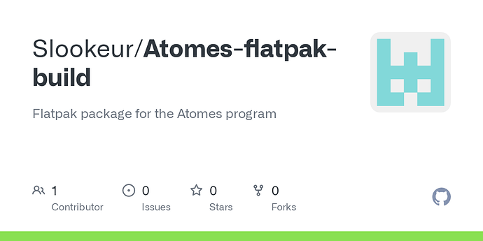

and try to change it … you will find the manifest here (‘myapp’ is actually ‘atomes’)
