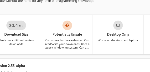

As of today, there is a “Potentially Unsafe” warning with this:
Can access hardware devices; Can read/write your downloads; Uses a legacy windowing system

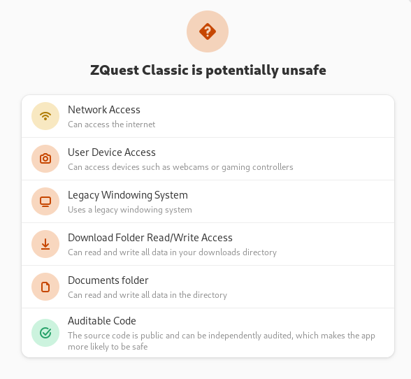

Going through the specific permissions:
  1. “Can access hardware devices” - we support gamepads. As far as I can tell, there is no more-granular permission to request.
  2. “Can read/write downloads” - We could probably change this to just reading; but the reason for this is to make downloading assets from an external site simpler to load into the program (asking a user to move files to the right place would be a headache)
  3. The legacy windowing thing - yeah, that’s something we should change. No problems with this warning.
Ideally, flatpak would support some more granular perms for the gamepad usecase; but what would really help is if we could provide a “justification” for each permission that an app requires in the flatpak config. As it is today, the current messaging around “unsafe apps” is probably a little more user unfriendly than it needs to be, and being able to explain each permission needed (right alongside its warning) may help.

I do mostly agree, but please be aware, that this (mostly) matches what gnome software does. And your non-technical users likely go through that to install.
Current gnome 44
New beta
In fact I’ve seem to have missed the implementation of the check for the documents folder on the website.

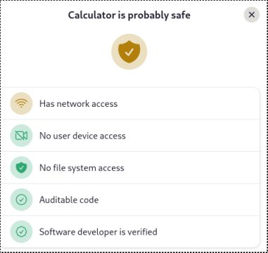

Exception is just one flatpak I use, which is marked as Probably safe and this is flatpak (Gnome) Calculator with “Has network access”. Interesting, why does Calculator needs network access?
EDIT: I have checked and one of the feature of Calculator is countries currency conversion and to get current currency rates, internet access is required.
