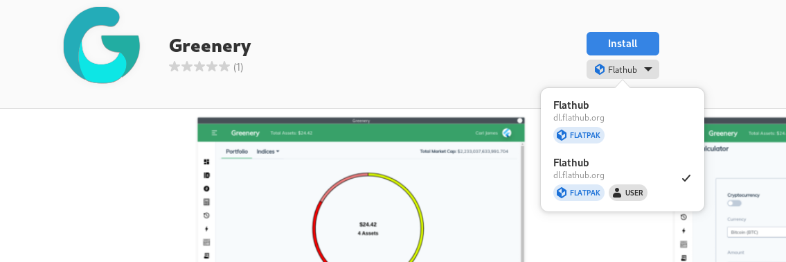

Also my local build does not show up in the Software app, the old version v0.9.8 shows up in the Software app after I build locally. I’m including a Screenshot below of what the drop down looks like. There is now a version labelled User?

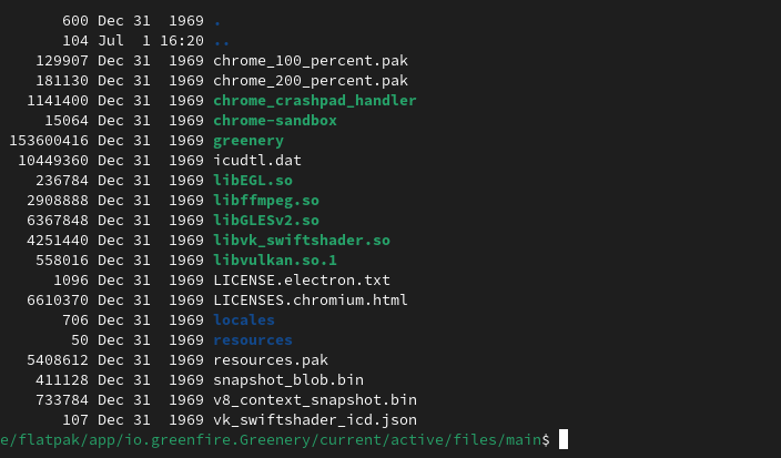

Also on my ~/.local flathub builds the binary is getting set to before Unix Epoch: 12/31 1969. This is happening across the .local build files

Are you sure that this isn’t simply your timezone? (check ls -l --time-style=full-iso)
I will check out timezone and revisit the Epoch issue.
Correct me if I’m wrong but I don’t think you can start your debug session from the start script. Unfortunately I won’t be able to help with this since I don’t know much about Electron apps.
I have to revisit the Node / Electron debugging within the Flathub runtime. Basically I have the shell command working but further debugging needs more configuring.
Do you know if Node / Electron apps are supported for debugging within Flathub runtimes? Do you know of anyone that has done it?
T
Replying to #6
I have gone through my system settings in Fedora 41 and set iso settings and checked them. I also executed this command:
for my local build and got this:
-rwxr-xr-x. 3 lexton lexton 424 1969-12-31 19:00:00.000000000 -0500 greenery
-rwxr-xr-x. 5 lexton lexton 26 1969-12-31 19:00:00.000000000 -0500 gvfs-trash
-rwxr-xr-x. 4 lexton lexton 2032 1969-12-31 19:00:00.000000000 -0500 patch-desktop-filename
-rwxr-xr-x. 3 lexton lexton 569112 1969-12-31 19:00:00.000000000 -0500 zypak-helper
-rwxr-xr-x. 3 lexton lexton 367928 1969-12-31 19:00:00.000000000 -0500 zypak-sandbox
lrwxrwxrwx. 1 lexton lexton 25 2025-04-17 15:25:48.991365394 -0400 zypak-wrapper → /app/bin/zypak-wrapper.sh
-rwxr-xr-x. 4 lexton lexton 285 1969-12-31 19:00:00.000000000 -0500 zypak-wrapper.sh
I am also seeing this popup for VS Code, Brave and other electron based apps that have the zypak-wrapper, all of them have Pre Unix Epoch timestamps so it is happening to release builds.

Replying to #8
As I suspected, it’s just your time zone, the timestamps are correct. You can actually display the unix epoch with ls -l --time-style +%s - I simply didn’t think about this at the time (it will be 0).
