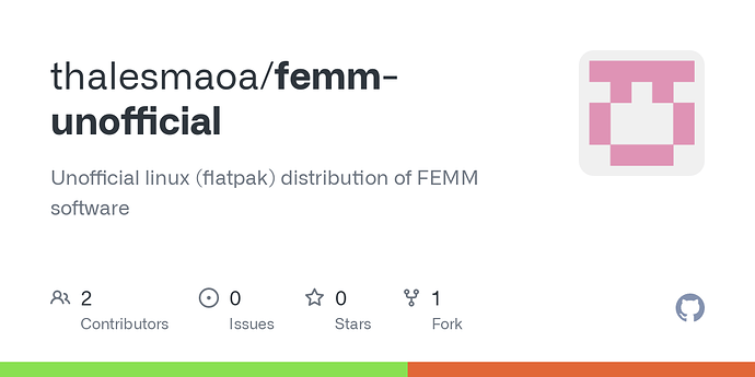

T
Hi @Andy, thanks.
Since my first post I’ve studied and tried a lot of things. Finally I got a working solution.
Suggestions are really welcome.
