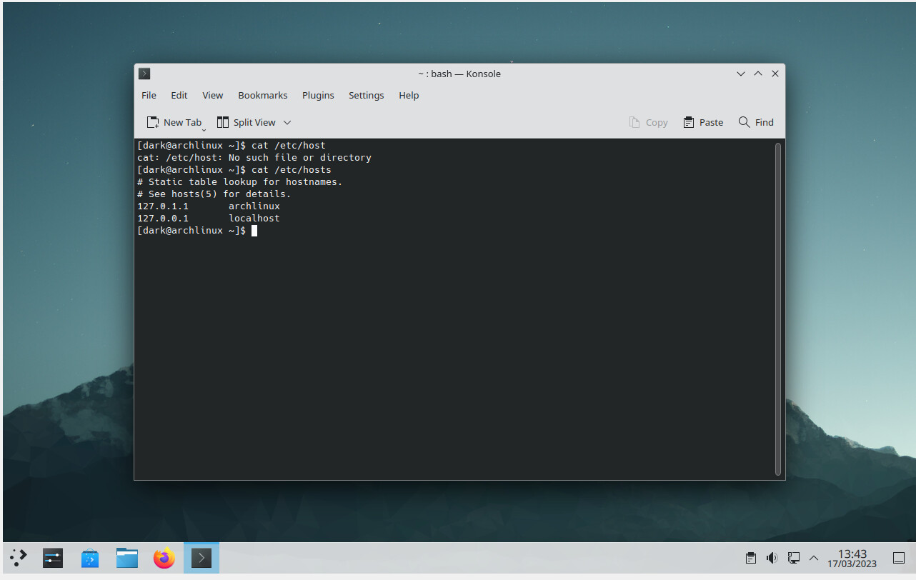

Someone said this on Discord, but I’m not sure what the before/after of the hosts file was:
I just tested an install of arch Linux and had the same issue initially but fixed by modifying the hosts file & rebooting
D

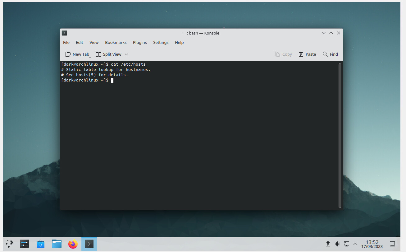

Original, Broken Hosts

Modified, Working Hosts
