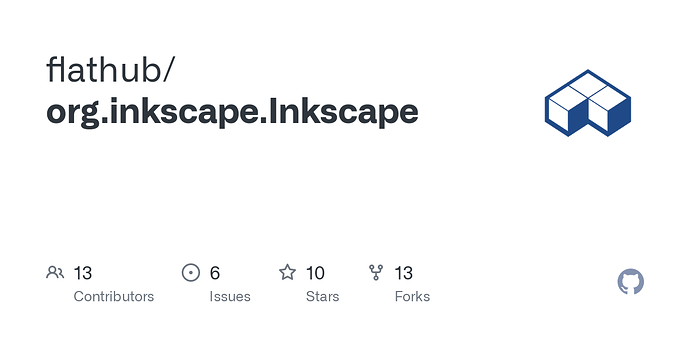

Scribus and Inkscape both install tkinter separately. You can use that as an example.
T
Replying to #2
How can I see their manifest files? I’ve been looking for a way to get Scribus’ one, but I can’t seem to be able to do so.
Y
Replying to #3
the flatpak manifest of scribus
Inkscape
and the module they use
you can search in manifest here
Y
Replying to #4
Some apps that use tkinyter ( i hope some day a generic way to maintain this)
