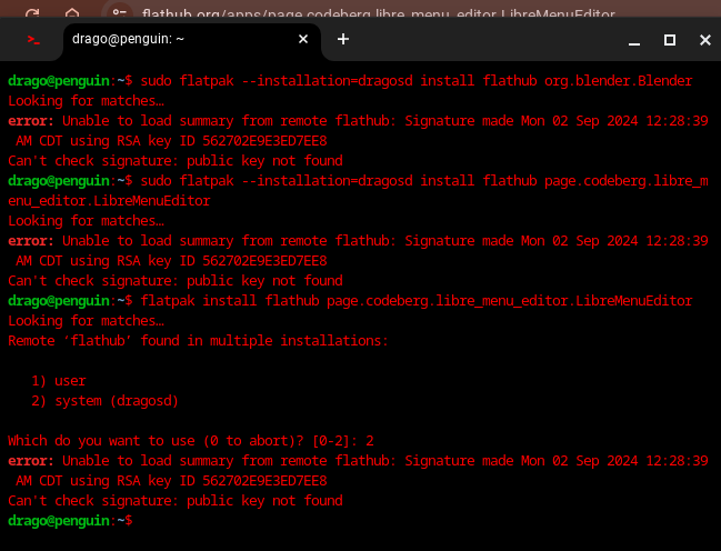

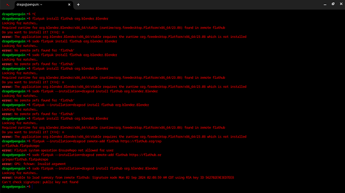

I’m on a chromebook. now as we all know chromebooks are already TERRIBLE for gaming as it is, and now i’m running out of memory much quicker than expected. i have a 1tb sd card inserted but i don’t see any way to install flatpak apps onto it, i searched it on google but most methods seem outdated as when i try them i usually get path not found or permission errors. can anyone give me a "STRAIGHTFORWARD answer on how to install flatpak apps on a chromebook’s SD Card?

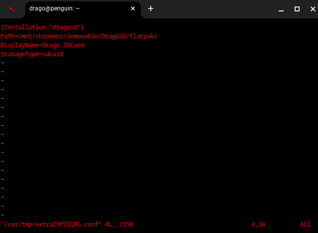

You need to add a custom installation pointing to the sd card: Adding a custom installation

well i’ve just completely powerwashed my chromebook. i just installed flatpak. with that being said, its a completely blank slate. what can i do from here? (should i try the custom installation thing “again”?)
M
Replying to #4

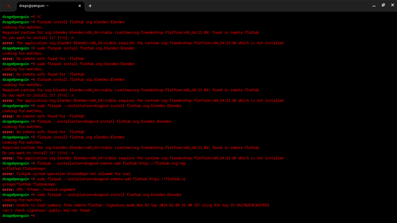

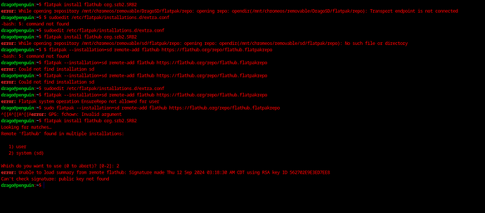

welp i decided to follow the tutorial again.
everything seemed to work right up until this point.
now i’m left with gpg errors

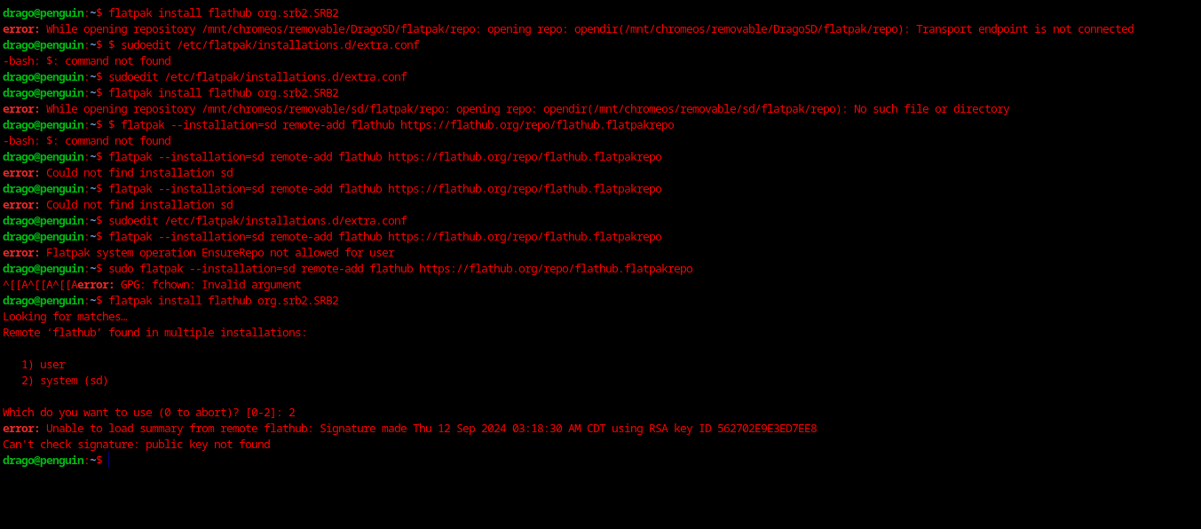

M
Replying to #7
also, this is “/etc/flatpak/installations.d/extra.conf”

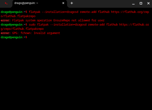

Are you using a Windows / FAT or exFAT formatted SD card? (I don’t know if this works on ChromeOS, but you can try lsblk -f to list all devices).
This doesn’t seem to be compatible, it fails here with the same errors. You’ll have to use a compatible, preferably Linux, filesystem (ext4, xfs, btrfs, probably f2fs). NTFS, if Windows compatibility is required, seems to work too but it’s probably not very well tested.
M
Replying to #12
FAT. also the command “works” but not as intended in chromeos.
M
Replying to #12
I have recently formatted my sd card to exFAT
M
Replying to #12
just executed this:
V
the technique is presently either obsolete or missing data as it should as of now not be possible the same way.

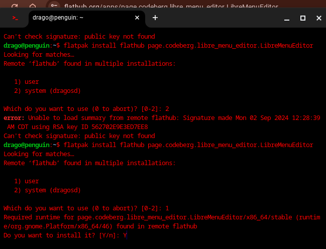

After a bit of tinkering around with ChatGPT i was able to install flatpaks to an sd card just fine. I am also on a chomebook but i am not on chromeos!
And i formatted my card to ext4 since fat32/vfat wouldnt
Step 2: Install the Public Key
You might need to manually import the GPG key for Flathub:
flatpak --installation=sdcard remote-add --if-not-exists flathub https://flathub.org/repo/flathub.flatpakrepo
Now try reinstalling your app
If it still shows the public key error, run the following to add the key:
wget -qO - https://flathub.org/repo/flathub.gpg | flatpak --installation=sdcard remote-add --if-not-exists flathub -
(remember to change installation=sdcard to whatever your installation location is named)
