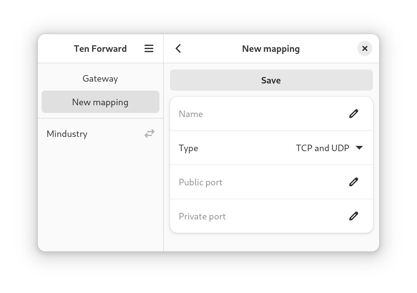

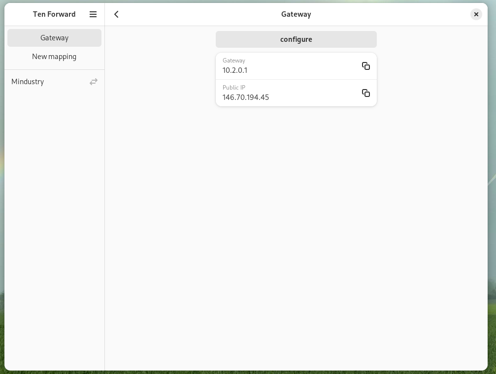

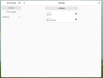

My app fails multiple metadata guidelines. While most seem easy to fix, I’m not sure at all how to fix the screenshots.
I took the initial screenshots on a white background, but the guidelines expect the background to be transparent and still have the shadow. I’m not sure how to achieve that without removing the background manually and re-creating the shadow over transparency with an image editing tool.
Also, the guidelines taught me that the screenshots can be language specific. Is it also possible to have screenshots for both light and dark mode and have the interface show the one that corresponds to the user’s preference?

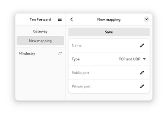

Do you think that screenshots like this would be better?
I installed Gnome to take them and indeed the shadows look significantly better.
screenshot-new-mapping.en
R
Replying to #4
Yes, that would be better, if the pixel sizes don’t get too small. Should be about 700 to 1200 width ideally

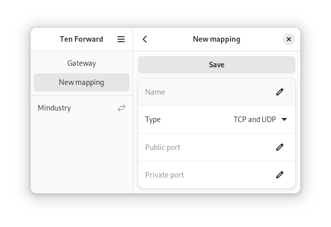

S
Replying to #5
I’s only 659x452, that’s indeed not a lot, but by setting display scaling to 200% I was able to get a much higher res image of the same content.
This also prompted me to change the default window size to something that made sense for the screenshots and therefore also makes sense for most users.
