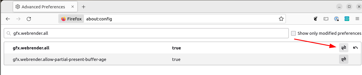

  2. In Firefox, type about:config in the URL bar and set the following settings:
    gfx.webrender.all=true
    media.ffmpeg.vaapi.enabled=true
    media.ffvpx.enabled=false (maybe not required anymore?)
    media.av1.enabled=false (maybe not required anymore?)
    Tip: Clicking the double-arrow icon will set the value to true or false

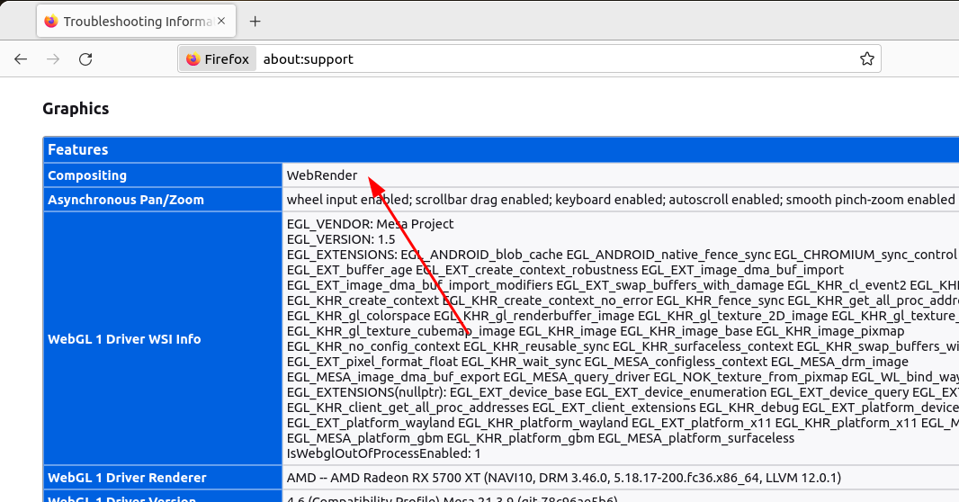

  1. In Firefox, type about:support in the URL bar, go the “Graphics” table, and confirm that “Compositing” is set to “WebRender”
