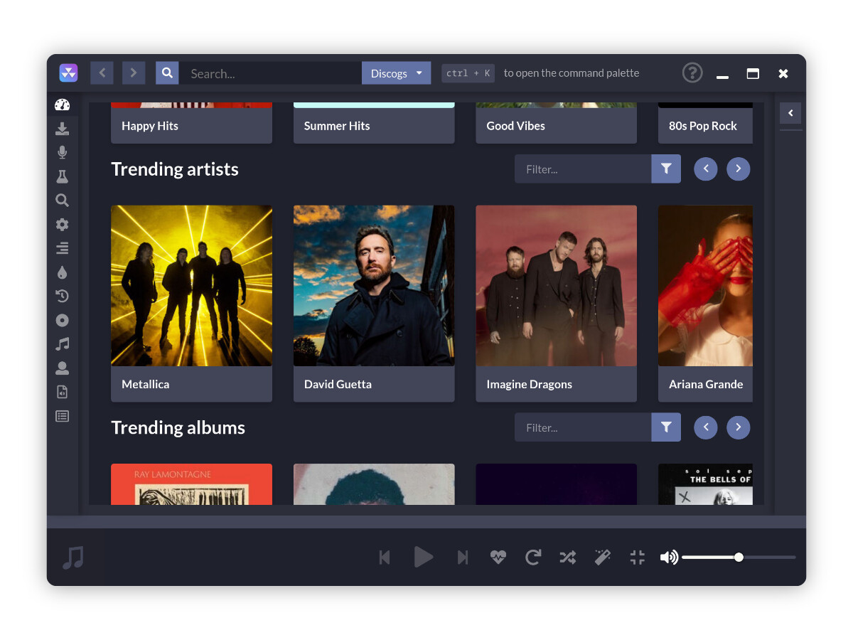

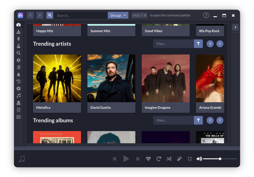

Thank you for the tips. Concerning the screenshots, I found a good way to generate compliant ones, but I’m still not sure when it comes to their size. Here are two alternate versions of the same screenshot for comparison:
(I’m going to put the other one in the next post because Discourse limits me to 1 embedded image per post)
The first is 1200x900, but the actual captured area of the program is 1000x700. The second one is 1000x700, and the captured area has been scaled down to allow some room for the shadows. Which one would be preferrable?

And here’s the second image

Both images should be fine.
Easiest for us is if you screenshot on KDE or Gnome, we haven’t really talked much about how to handle it for other desktops. As it get’s very complicated.
Even figuring out which default settings for KDE are the current ones, was surprisingly involved.
