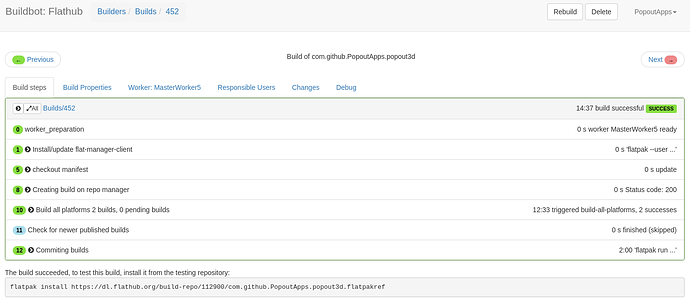

Same problem. I saw a “Publish” button at some point, but not since. The app was built successfully so I waited the nominal 3 hours for it to be automatically published - nothing. I rebuilt it and waited, it disappeared off the list after 2 hours without being published.

I’ve since rebuilt it successfully, I’m signed in and there is no sign of a “Publish” button.
I have seen another thread about “Failure to publish shown as success”. Perhaps this was a failure to build shown as a success? That would explain why it wasn’t published automatically and why there was no “Publish” button. However installing from the link that follows “The build succeeded, to test this build, install it from the testing repository:” results in a working app of the latest version.

From post 7 - “The app was built successfully so I waited the nominal 3 hours for it to be automatically published - nothing. I rebuilt it and waited, it disappeared off the list after 2 hours without being published.” That’s why I was looking for the “Publish” button. I’ve had about 5 attempts so far, Build 457 has had 3 hours, I’ll wait a little longer. After that all I can do is repeatedly rebuild it until it gets published. That seems a waste of processing power but I can’t think of any other way. When I get to 10 attempts I’ll either post again here or open another thread.

It seems that on GitHub I had to “Merge the branch” to make it an “Official” build. That’s news to me - I’ll never understand GitHub (:. Now showing on Flathub.
