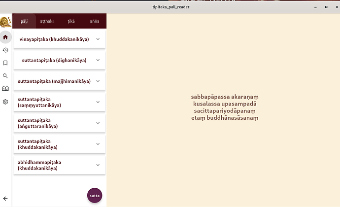

I’m nearly finished to submit my flutter app to flathub.
I have a few errors when I run from the command line yet the app runs fine with these command line errors. Can anyone explain what they are and how to satisfy these reqs.?
I guess I need to put them in the yml file?
I’m using ubuntu mate 22.04 to build with latest flutter.
flatpak run org.paauk.TipitakaPaliReader

I’ve used the last 15 min to figure out your problems. Most just worked, you only had appdata woes. GitHub - razzeee/org.americanmonk.TipitakaPaliReader
It’s mostly due to badly coping stuff without reading. Your appdata file is named wrong for e.g. I now copy it to the right name.
And frankly your app metadata/desktop files are in a very bad state.

TBH, Flutter is horrible on linux - somebody who doesn’t understand linux build it. But that’s just an opinion. Also fails to look correctly on linux most of the time. Your app for example has no rounded corners on the bottom…
I’m not complaining about your file names having underscores, those are fine. But the name in the desktop file and appdata file shouldn’t. That for e.g. causes this in the header bar
Did you try to run it twice? Also did you upload that new zip somewhere?

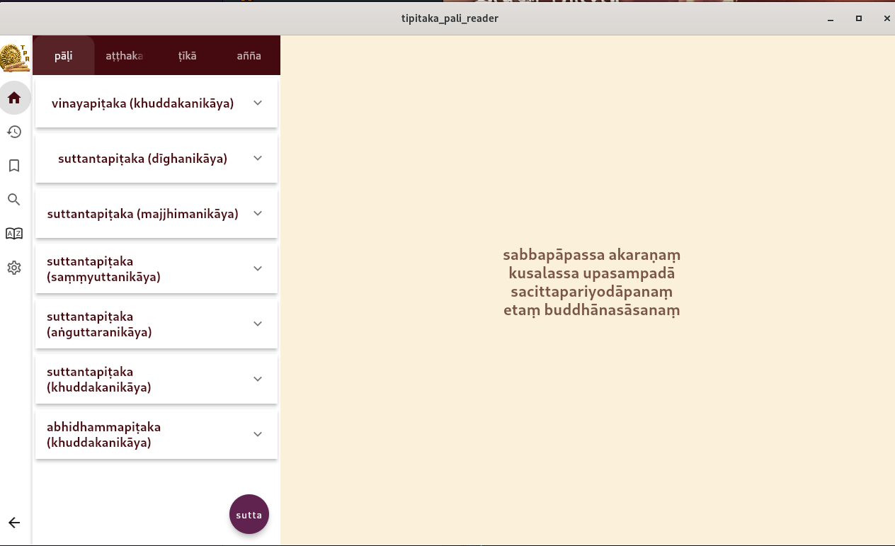

Well… I was finally accepted to flathub, but those errors did not work with one user who is on Linux Mint. I think the other tester told me it failed and he was on PopOS.
I would imagine these libraries were not included on non full ubuntu distros. After all the frustration and finally ending on flathub, I was all set to make a video… " as promised" However, I cannot accept this as “finished” or “acceptable” … The user who tested told me he used more than 1.5gb of downloading data (on mobile) just to install, whereas the appimage is less than 120mb. the appImage works on linux Mint. FlatPak does not work.
If someone helps, I’ll see what I can do… if not , I’ll give up on this again.
Error is below:
flatpak run org.americanmonk.TipitakaPaliReader
ERROR: ld.so: object 'libgtk3-nocsd.so.0' from LD_PRELOAD cannot be preloaded (cannot open shared object file): ignored.
Gtk-Message: 16:06:22.999: Failed to load module "xapp-gtk3-module"
malloc(): unsorted double linked list corrupted

The download is less than 119 mb for me on my main system to install, your tester likely never hand a flatpak installed before, that’s why it needed to pull in the base images.
I’ve also just installed mint 21 in a vm and your app starts without any problems. It proceeds to download the word list as expected and then shows the homescreen.
Closing and starting it again also works without problems - it only shows a what's new diaglogue that’s a bit confusing. I would just remove that from the flatpak version.
I also didn’t run any mint updates after install, to simulate an “old” system. And the flatpak worked fine. I then updated mint to the latest and rebooted. After that the flatpak still worked without a problem.
