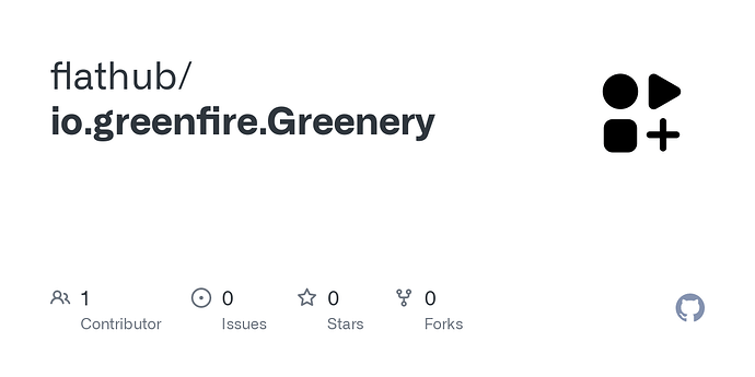

I have submitted a new app called Greenery that has been accepted and is now listed. There is now a new update for the app and I want to add changelog details and release history.
Do I use my User Github Fork of Flathub to make the PR App Update or do I submit a PR to my Flathub Greenery repo (master) which is here:
Also how should I name the Commit? Should I include that app version being updated? Do I submit the PR on the master branch?
