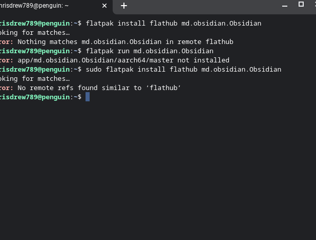

Can anyone help? I am trying to install an app and have no idea what I am doing. See screenshot
Many thanks (also have noted not to use sudo but did not before)
Chris

Hi Chris. Looks like your computer is aarch64, md.obsidian.Obsidian only available in x86_64.
C
Replying to #5
Thank you, I have now discovered it is 32bit so think you are correct.
H
Replying to #6
It appears that now there is an aarch64 (ARM in 64bit) build for that package that you should be able to install.
(btw neither is “32bit”)
