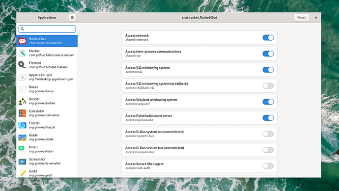

G
Not sure if this would fit the bill but I guess you could at least try it
