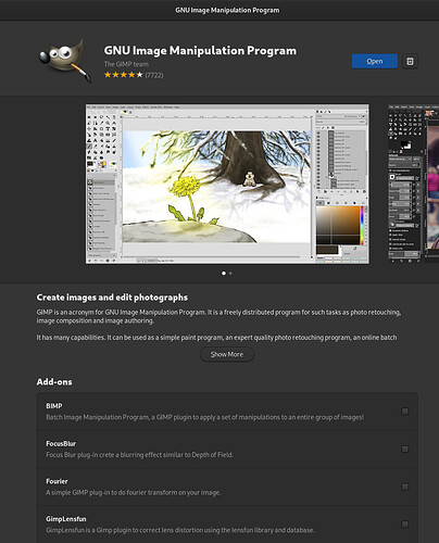

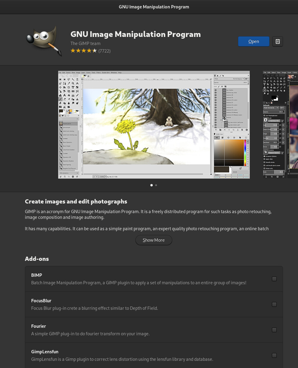

I could not make an up-to-date screenshot of how that would be shown in GNOME Software, but in the past at least you could see extensions there (called “Add-ons”, apparently):
(Viewing GIMP in GNOME Software 47.2 though does not show any of these, I am unsure whether GIMP or GNOME-Software changed here.)
In the end, if it is shown here, that would just be one additional click.
