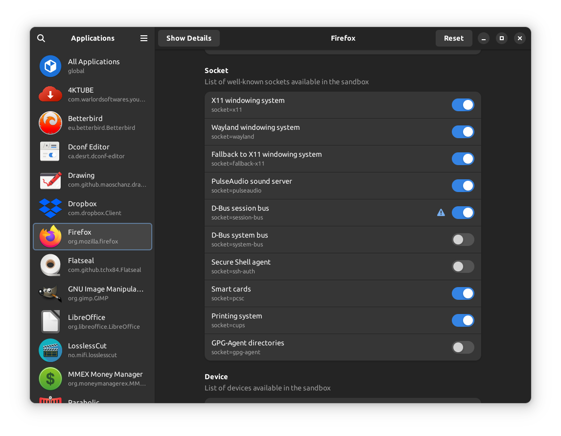

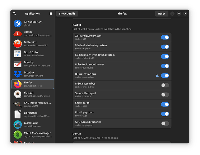

I recently installed FF Flatpak on Debian 12.5 and discovered this issue.
I have now resolved it by also installing Flatseal.
Select Firefox from the left pane and set switch ON for D-Bus session bus. This will allow installed system printers in Firefox to be seen by PDFs &etc listed in the dialogue drop down box.
G
UPDATE 29 May 2024
A month in since I changed the settings in Flatseal (see prior post) and the issue has re-emerged.
Fixed it again by recycling the D-Bus settings in Flatseal (Firefox application) adding in D-Bus system bus this time but still no fix until FF was closed then re-started then it performed as required.
Has anyone managed to find a persistent fix for this long outstanding issue or should I just abandon the Flatpak version and run with the .deb version instead link here or are there other settings to try I have missed?
