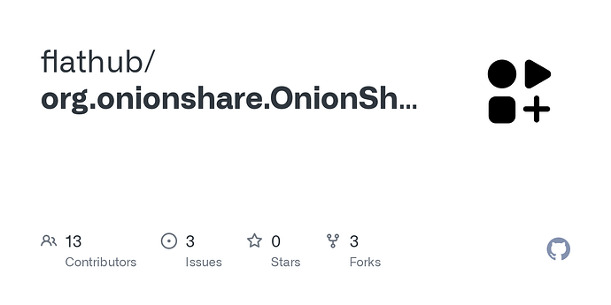

Best is to report the issue directly with the flathub package:
Chances the maintainer sees it are higher.
