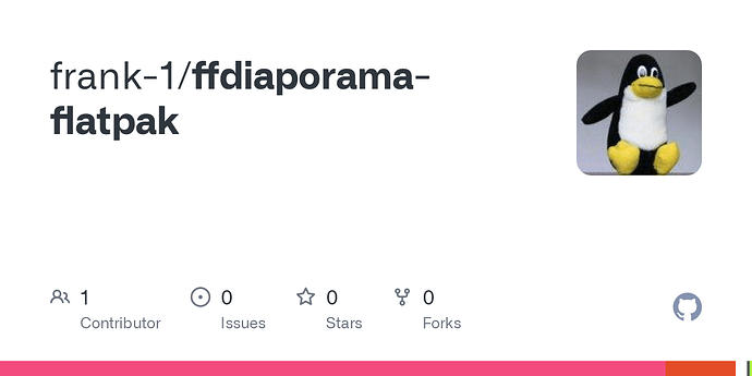

F
Replying to #13
I changed my steps here:
