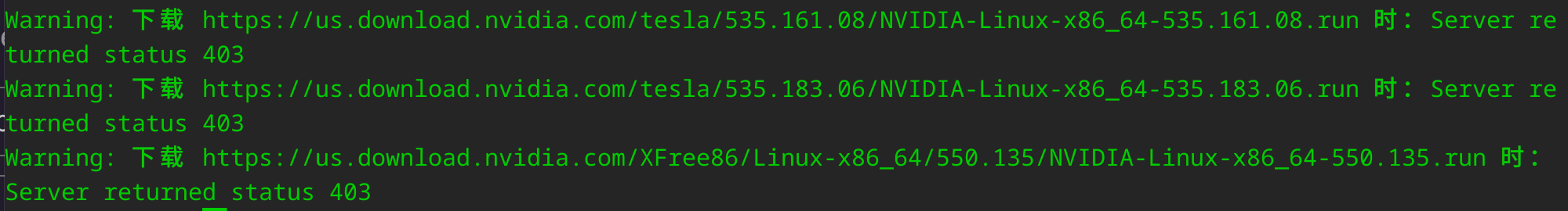

Hi,
I am trying to update my APP using the command “flatpak update”. It shows that I need to update “org.freedesktop.Platform.GL.nvidia-535-161-08”, “org.freedesktop.Platform.GL.nvidia-535-183-06”, and “org.freedesktop.Platform.GL.nvidia-550-135”. However, during updating, I receive the error messages as below:
My Linux system is Deepin V23.
Could anyone let me know what is the problem and how can I update these items? Thanks.

In short: Flatpak tries to download the NVIDIA drivers from their servers, but the server refuses the download.
This could be, for example, because the IP address you use has been blocked by the server for some reason.
They may block for example certain IP addresses from certain VPNs.
