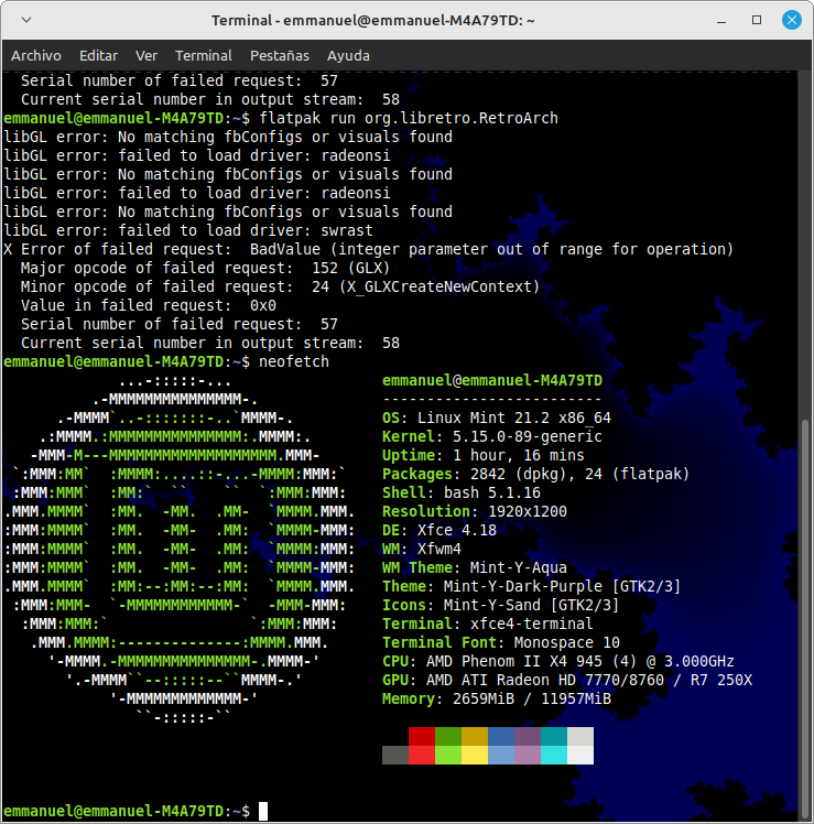

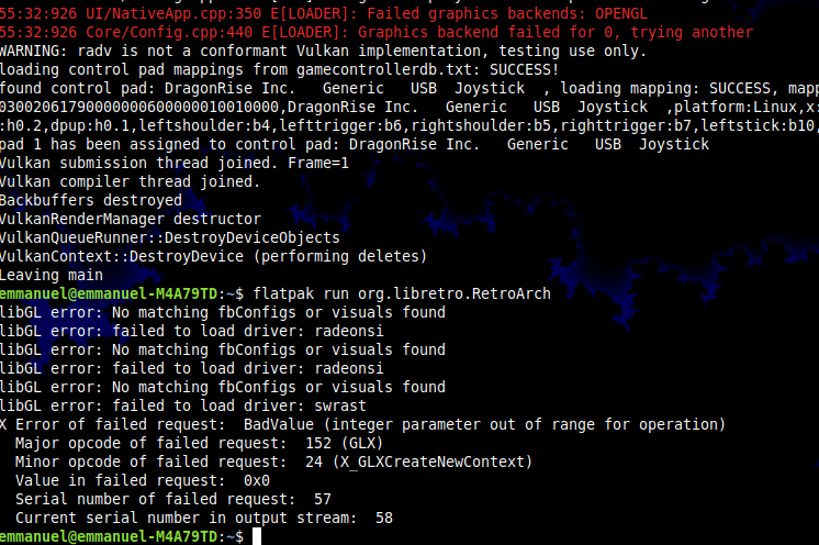

Well I lost the page where it explained how to switch from radeon to amdgpu :sweat_smile: .
Anyway there was a flatpak Freedesktop.platform update today, it includes mesa drivers 23.3.0 , the same version that gave me issues with the system drivers, so I installed both to test what happens.
Now mGBA, Dolphin-emu, Blender, and PPSSPP works just fine; but libreto.Retroarch still gives the same error as before. Also, I note that PPSSPP gives some errors, but then it continues anyway.
Here is a screenshot showing the errors from PPSSPP and Retroarch:
A

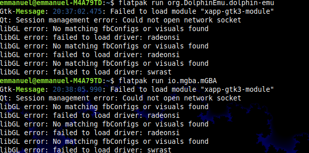

Here is a screenshot from yesterday showing the errors with DolphinEmu and mGBA:
imagen
Same as retroarch they tried to open and then closed.
Now, they work just fine, but retroarch is still not working.

RetroArch uses an older runtime which is based on 22.08 of the Freedesktop runtime (org.kde.Platform 5.15-22.08). That’s why the other applications are probably fixed: Mesa was only updated for 23.08, 22.08 is still on 23.1.9.
It seems RetroArch is in progress to be updated, you could report your issue there (Please update Runtime org.kde.Platform to 5.15-23.08 · Issue #260 · flathub/org.libretro.RetroArch · GitHub). This would at least work around the issue.
You can check if an issue already exists on the runtime tracker &, if not, report it there: freedesktop-sdk / freedesktop-sdk · GitLab
