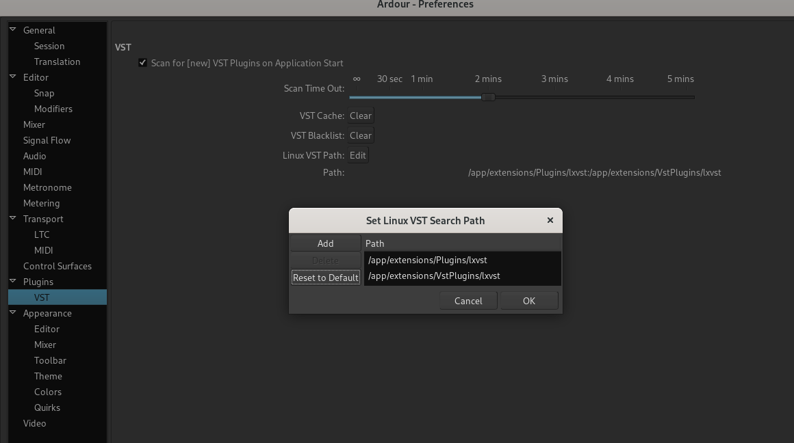

After I updated to unified and also included vst plugins, Ardour finds Lv2 one’s, but it’s VST search path is still /app/extentions/VstPlugins/lxvst. Adding path manually does the trick.
Lmms (carla) cannot see either. UPD.: Adding additional plugin paths in Carla settings manually fixes that.

In Ardour I had to reset the path for the VST (LV2 is fine).
Screenshot from 2020-07-02 10-04-21
Same in Carla I think.

Ah, so fresh installations of those apps should be OK by default. Also, tested resetting in carla - works.

You notice that in Ardour it’s only VST. LV2 or LADSPA don’t have that problem.
T
Replying to #25
Ardour probably just honours environment variables for ladspa and lv2, that’s why those work. Carla has paths set in some config - hence everything needs to be reset.
