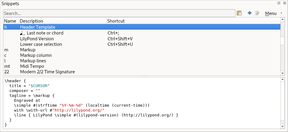

For the records, I had to remove the screenshots of the application panels (which are not windows), because the screenshot made by GNOME would not pass the Flathub validation.
PR: Follow Flathub's metainfo quality guidelines by fedelibre · Pull Request #1842 · frescobaldi/frescobaldi · GitHub
Image removed:
