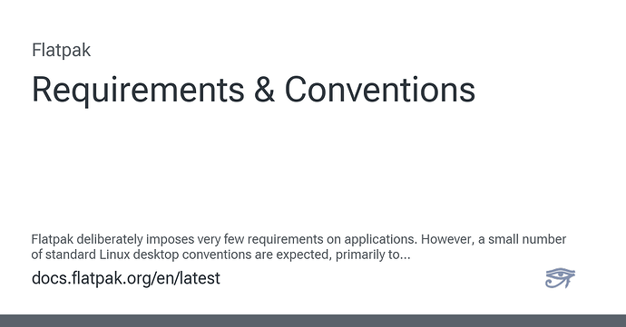

See the Flathub documentation about which id you should use:
Y
Applications using code hosting IDs and hosted on github.com, gitlab.com, codeberg.org, framagit.org must use io.github., io.gitlab., page.codeberg., io.frama. prefixes respectively and must have at least 4 components.
