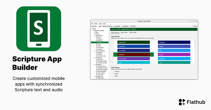

In opengraph tags (whenever you share the link) See OpenGraph - Preview Social Media Share and Generate Metatags - OpenGraph and on the front page banners.
C
I have updated the summary for both org.sil.scripture-app-builder and org.sil.dictionary-app-builder and they are in review.
R
They are used on the website, if you are featured on the home page. Or for your social card, when the app gets shared on websites, like here.
