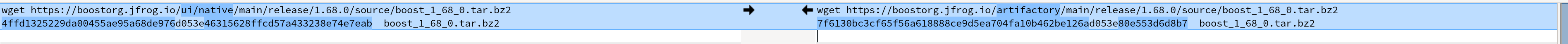

I think I found the problem. There are 2 CDN URLs which give files of the same name but with different contents. Presumbably this is a mixup between them, you’ve checked one of these locally and put the other in your Flatpak manifest.
wget https://boostorg.jfrog.io/ui/native/main/release/1.68.0/source/boost_1_68_0.tar.bz2
4ffd1325229da00455ae95a68de976d053e46315628ffcd57a433238e74e7eab  boost_1_68_0.tar.bz2
wget https://boostorg.jfrog.io/artifactory/main/release/1.68.0/source/boost_1_68_0.tar.bz2
7f6130bc3cf65f56a618888ce9d5ea704fa10b462be126ad053e80e553d6d8b7  boost_1_68_0.tar.bz2
