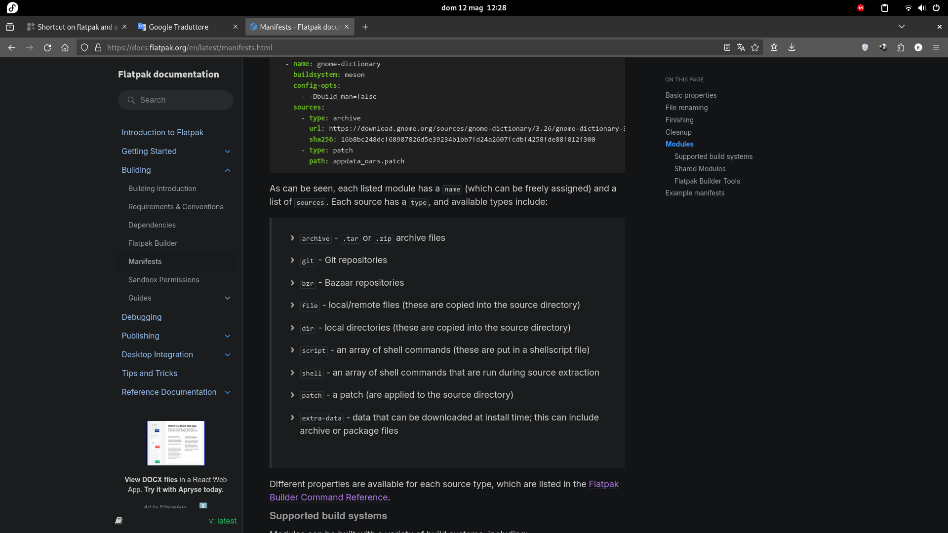

The fact that in the documentation I can’t find a practical example of what I want to do. I’m using ChatGPT, this gives me these solutions. But it’s strange because the .flatpak file is created for me, then
> - post-install: post-install.sh
> override-cmd: /post-install.sh
must be valid lines of code
E
As you can see in the image in the ‘Modules’ section there is the ‘script’ type
C
It’s not. The “AI” is just not intelligent. If it’s not in the documentation then it doesn’t exist. Check the build output, it’ll contain warnings.
The script type is a different thing anyway.
As I said: The way you try to do it does not work, you have to do it when you’re application is running.

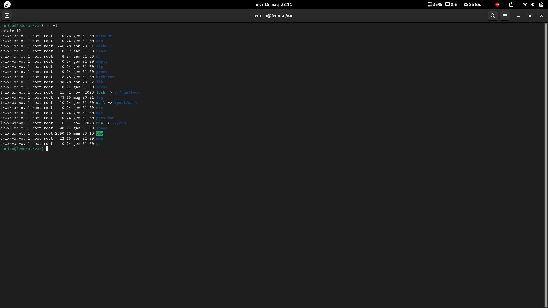

Which folder is intended to contain permanent data that any user can both see and modify (besides /home)?
Trying to find out online I read several times that the /var folder should be used for this purpose. However, using Fedora I realized that I cannot create other folders in /var unless I am root. And checking with the command: (ls -l) I can’t find any folder that has read and write permissions for any user. I know well that I could create it myself, but it seems strange to me that, for example, a /var/data folder that has this feature by default has not been created. I thought about this because if I ever decided to create a management system whose archive is accessible to any user who has access to the PC, I wouldn’t know in which directory to put the archive. Thanks everyone for the help.

Have a look at the xdg folder/basedir spec you want to use the env variables provided on the system for this
https://specifications.freedesktop.org/basedir-spec/basedir-spec-latest.html
https://wiki.archlinux.org/title/XDG_Base_Directory
