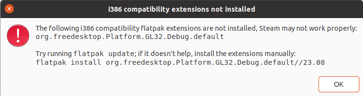

i installed the steam from flathub, but after install not started:
flatpak run com.valvesoftware.Steam
bwrap: Can’t mkdir parents for /app/lib/debug/lib/i386-linux-gnu/GL: Read-only file system
error: ldconfig failed, exit status 256
what this?
many thanx
zsolt

I have the same problem, I update all flatpak packages for steam, then update flatpak via ubuntu’s ppa (1.14.4) and now I have this error, how can I fix it?
D
TLDR: “Solution” flatpak remove org.freedesktop.Platform.GL32.Debug.default//23.08 and ignore steam warning
I try to uninstall > reinstall it works for the session, but on restarting it again returns the same error ¬¬.
Then I remember Steam after installation asked for flatpak install org.freedesktop.Platform.GL32.Debug.default//23.08 This is the package that broke the app, I uninstalled it and ok.
It was not installed with root, Flatpak version
1.14.4
C
Replying to #5
You don’t need that extension.
What’s happening is that you have org.freedesktop.Platform.GL.Debug.default installed, and so the steam_wrapper script is suggesting that you also install the 32-bit version. Unfortunately, the extension fails without also having org.freedesktop.Platform.Compat.i386.Debug installed.
