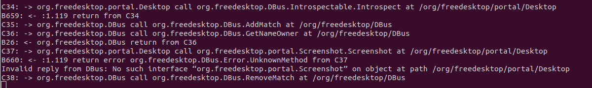

This gives me now following error
I’m obviously still doing something wrong.
F
Replying to #3
org.freedesktop.portal.Desktop → Service
/org/freedesktop/portal/Desktop → Path
That should be /org/freedesktop/portal/desktop.
D
That should be /org/freedesktop/portal/desktop .
Thanks, that was helpful again. Now I’m at the method call, the method seems to be correct but I’n not sure what I’m supposed to pass as parameters?
