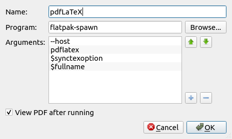

In texworks the commands need to be set as in the picture below, by adding flatpak-spawn as the command, --host as the first argument, then the real command:
If you want to change them all I uploaded a gist at TeXshop flatpak, tex host config · GitHub
You can save that file as ~/.var/app/org.tug.texworks/data/TUG/TeXworks/configuration/tools.ini
