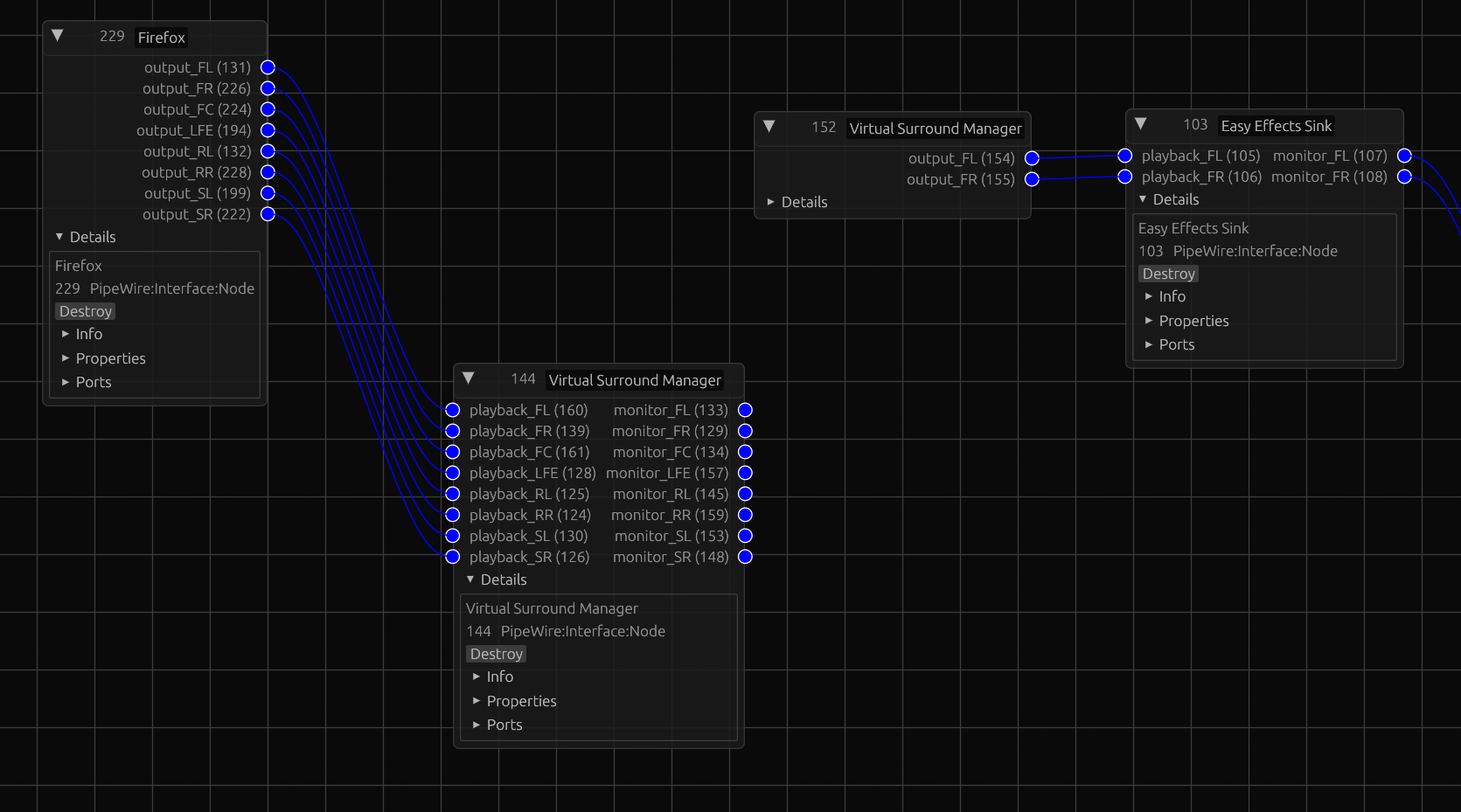

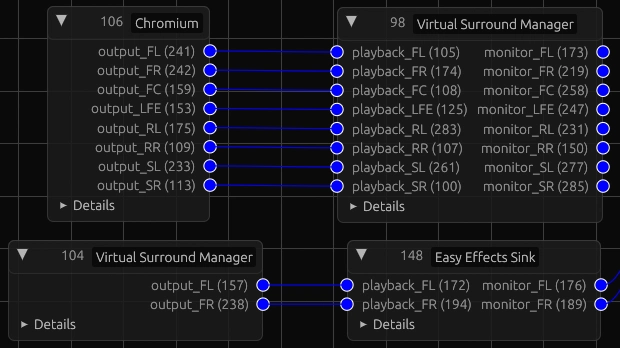

It should look like this in coppwr when everything works:

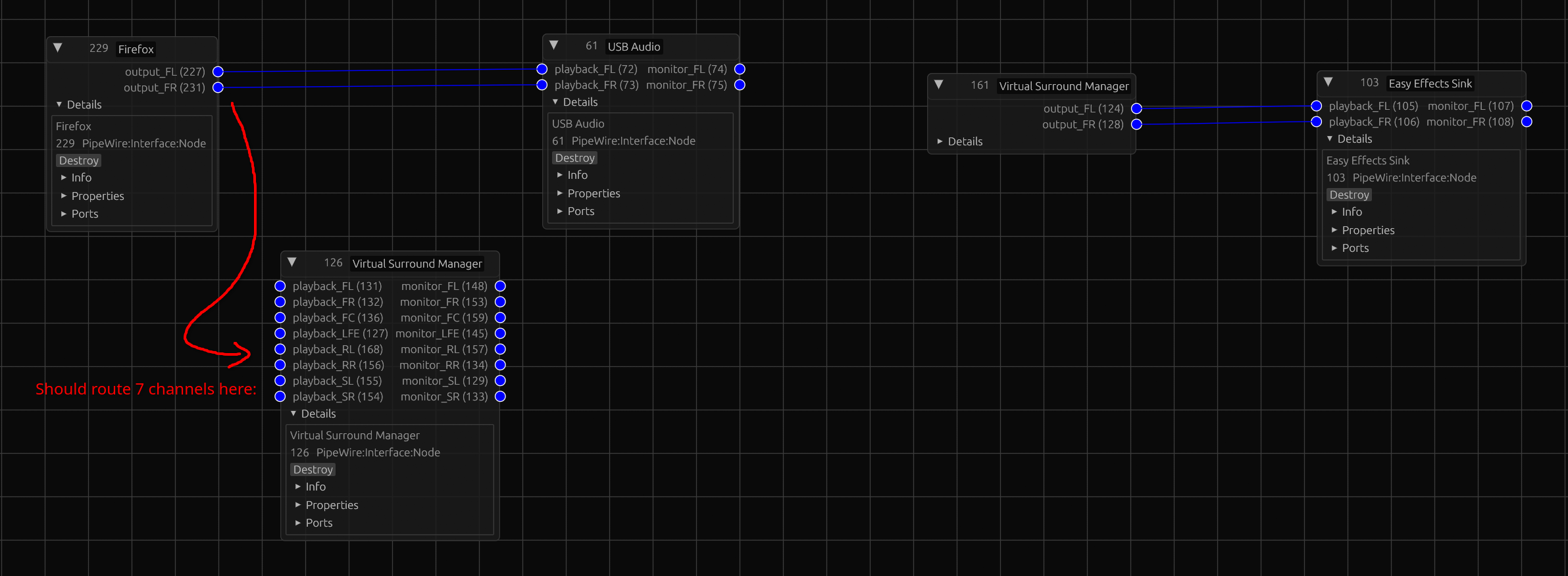

Everything indicates it should work, but it actually does not route the audio. It does not create the route from the app (Firefox here) to my virtual sink. See in coppwr:
This is how it looks like in my native installation and AppImage:

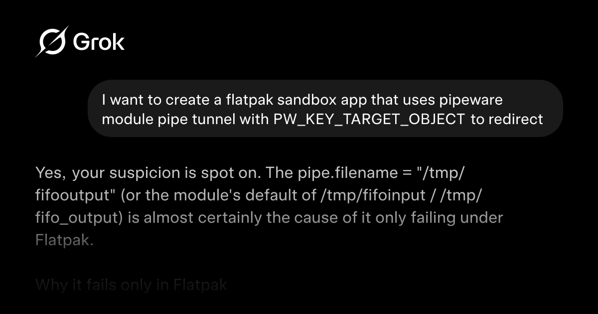

I run your question to Grok, including asking how EasyEffects works.. have a look it may put you in the right direction:
I’m not experienced on Pipeware so cannot help you further. Good luck.
The easyeffects question cannot link it, so I pasted it here:
Also related (I think you may be using this module which cannot work in Flatpak as uses a unix pipe): PipeWire: Unix Pipe Tunnel
