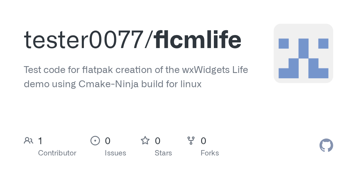

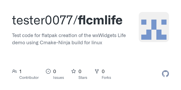

My progress has been slow, but I have now gotten part of the way.
My current test project is based on the latest wxWidgets demo ‘life’.
I have uploaded the basic code to Github and the package is available at:
It consists of the source code from the wxWidgets demos/life and includes a the CMake build script adapted from the blog https://www.justdevtutorials.com/post/wxwidgets-cmake/ for this code and for CMake-Ninja.
FWIW, the base CMake project still has a way to go and I am working on that in parallel. I evidently need more platform specific code fixes. Right now, I don’t see those issues getting in the way of my flatpak packaging.
The script to create the flatpak YML file and start the build process: flmakelife.sh
#!/bin/bash
# Install flatpak-builder - already installed on Mint
#sudo apt -y install flatpak-builder
# Create Manifest file
cat > org.cmlife.cmlife.yml  <<EOL
app-id: org.cmlife.cmlife
runtime: org.freedesktop.Platform
runtime-version: '22.08'
sdk: org.freedesktop.Sdk
command: life
#rename-icon: life
#rename-desktop-file: life.desktop
#finish-args:
#  - --socket=fallback-x11
#  - --socket=wayland
#  - --share=ipc
#  - --filesystem=xdg-documents
#  - --env=PWS_HELPDIR=/app/share/passwordsafe/help/
modules:
	# Note: the order of modules is important as the builder works its way
	# in a linear fashion - any dependencies need to be satisfied when
	# the process tries to build a module
  - name: wxwidgets
    cleanup:
      - /bin
      - /include
      - /lib/cmake
      - /lib/wx
      - /share
    sources:
      - type: archive
        url: https://github.com/wxWidgets/wxWidgets/releases/download/v3.2.2.1/wxWidgets-3.2.2.1.tar.bz2
        sha256: dffcb6be71296fff4b7f8840eb1b510178f57aa2eb236b20da41182009242c02
        x-checker-data:
          type: anitya
          project-id: 5150
          stable-only: true
          url-template: https://github.com/wxWidgets/wxWidgets/releases/download/v/wxWidgets-.tar.bz2
  - name: life
    buildsystem: cmake-ninja
    sources:
      - type: git
        url: https://github.com/tester0077/flcmlife.git
        branch: master
EOL
I run the script - under Mint 21.2 from a directory
~/Public/flatpak/flcmlife/flatpak/
While I can run this script with more success in my local build directory, but not all the way,
for this test case with the project code available from Github, I get stuck at a much earlier spot.
/Public/flatpak/flcmlife/flatpak$ ./flmakelife.sh
Downloading sources
Fetching full git repo https://github.com/tester0077/flcmlife.git
fatal: ambiguous argument 'master': unknown revision or path not in the working tree.
Use '--' to separate paths from revisions, like this:
'git <command> [<revision>...] -- [<file>...]'
Failed to download sources: module life: Child process exited with code 128
Obviously, I still have a lot to learn about most of this process. :wink:
Any help will be much appreciated.
