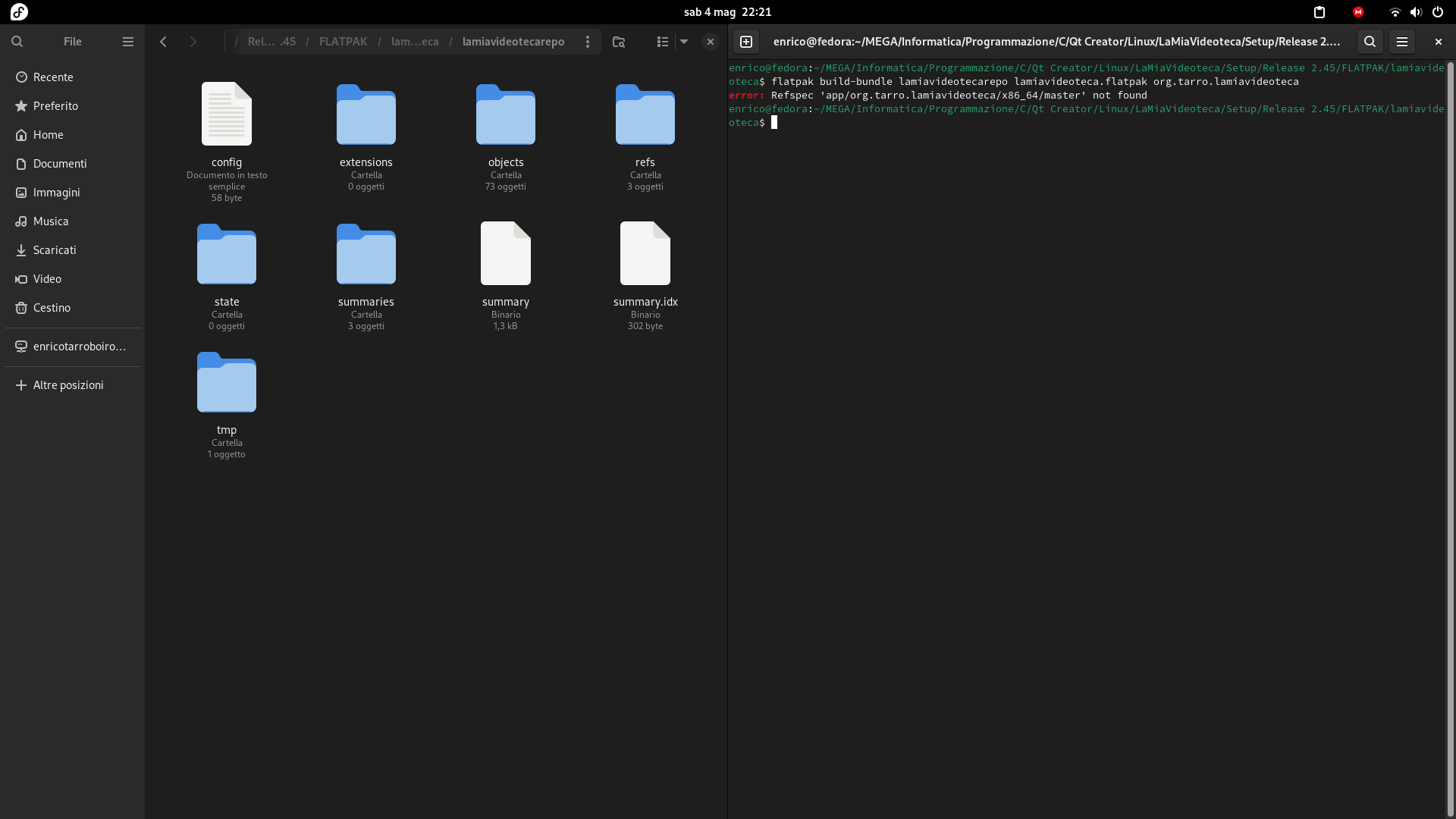

From what I understand by reading the documentation the flatpak build-export command creates a local repository, I have to use the flatpak build-bundle command to create the flatpak package, but I tried command:
flatpak build-bundle '/home/enrico/MEGA/Informatica/Programming/C/Qt Creator/Linux/LaMiaVideoteca/Setup/Release 2.45/FLATPAK/lamiavideoteca/lamiavideoteca.flatpak' lamiavideoteca.flatpak org.tarro.lamiavideoteca.flatpak
but it doesn’t work, it gives me
error: Refspec 'app/org.tarro.lamiavideoteca.flatpak/x86_64/master' not found

This is a community forum, people will answer when they find the time. You have to be patient.
But you already have the correct command syntax, now you just have to understand the error message, the documentation could be improved in this instance:
flatpak build-bundle LOCATION FILENAME NAME [BRANCH]
LOCATION is the repository from flatpak build-export or from flatpak-builder --repo=<REPO> (your location is the correct one).
FILENAME is just the output filename, whatever you define.
NAME is actually the application id. You just have to enter exactly your id (case-sensitive). Your id doesn’t (& shouldn’t) contain the .flatpak suffix, that’s why your application is not found.

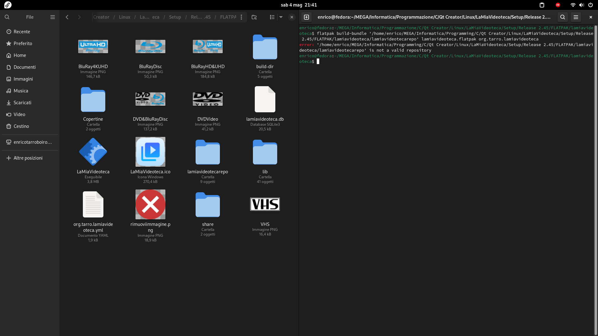

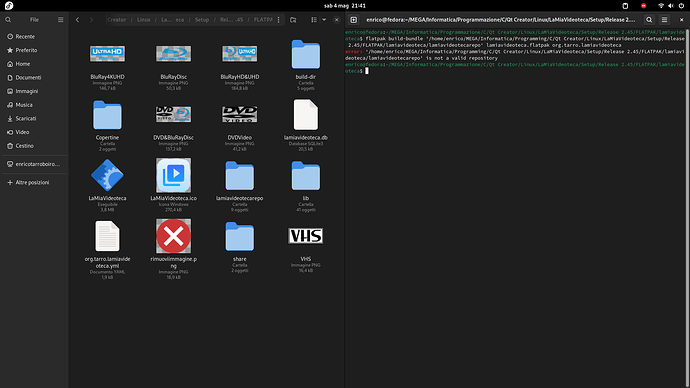

Thank you for answering me. I’m not in a hurry and I thought people were tired of replying to me. I changed the name of the repo to lamiavideotecarepo. I tried with the following command:
> flatpak build-bundle '/home/enrico/MEGA/Informatica/Programming/C/Qt Creator/Linux/LaMiaVideoteca/Setup/Release 2.45/FLATPAK/lamiavideoteca/lamiavideotecarepo' lamiavideoteca.flatpak org.tarro.lamiavideoteca
but I get:
error: ‘/home/enrico/MEGA/Informatica/Programming/C/Qt Creator/Linux/LaMiaVideoteca/Setup/Release 2.45/FLATPAK/lamiavideoteca/lamiavideotecarepo’ is not a valid repository
Yet the command I used to create the local repo should be right: `
> flatpak build-export lamiavideotecarepo build-dir org.tarro.lamiavideoteca
C

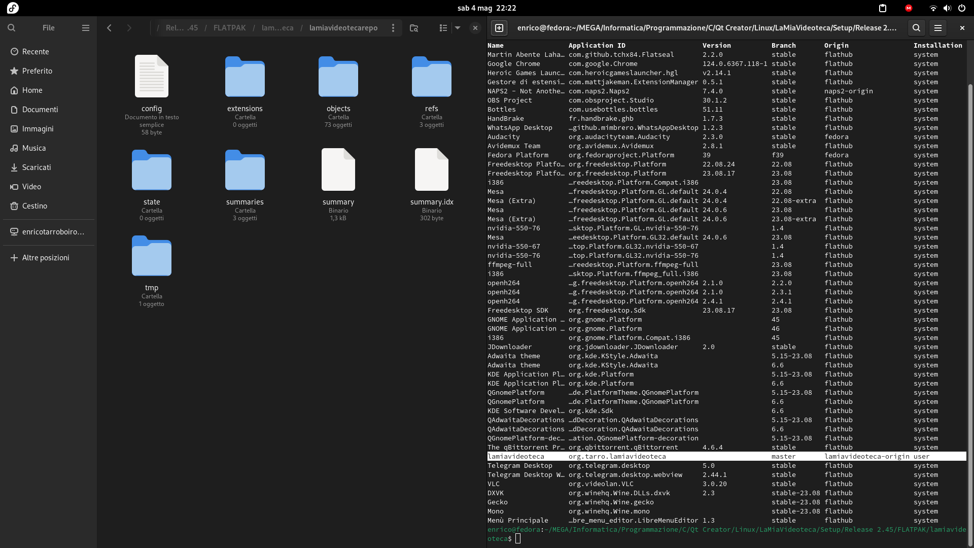

Most likely your path to the repo is not correct, that’s the error you get if the repo-folder does not exist.
Check the files of the repository, they should look like in the screenshot (Figura 3b):
ls ‘/home/enrico/MEGA/Informatica/Programming/C/Qt Creator/Linux/LaMiaVideoteca/Setup/Release 2.45/FLATPAK/lamiavideoteca/lamiavideotecarepo’
But you can just avoid the whole absolute path & just use lamiavideotecarepo instead (if everything is inside the current working directory).

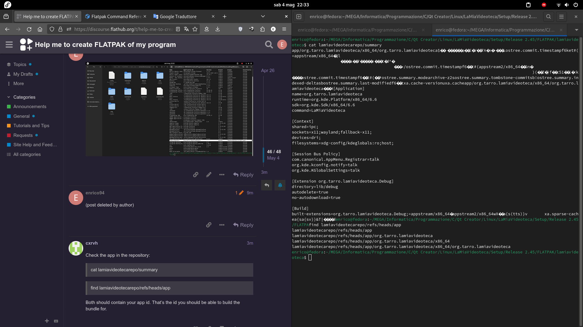

Replying to #49
Check the app in the repository:
cat lamiavideotecarepo/summary
find lamiavideotecarepo/refs/heads/app
Both should contain your app id. That’s the id you should be able to build the bundle for.

C
You have changed the branch name from master to org.tarro.lamiavideoteca. Then you must add it as last parameter to build-bundle (without the brackets).
But you should use a better branch name like stable, main, master or something like that.

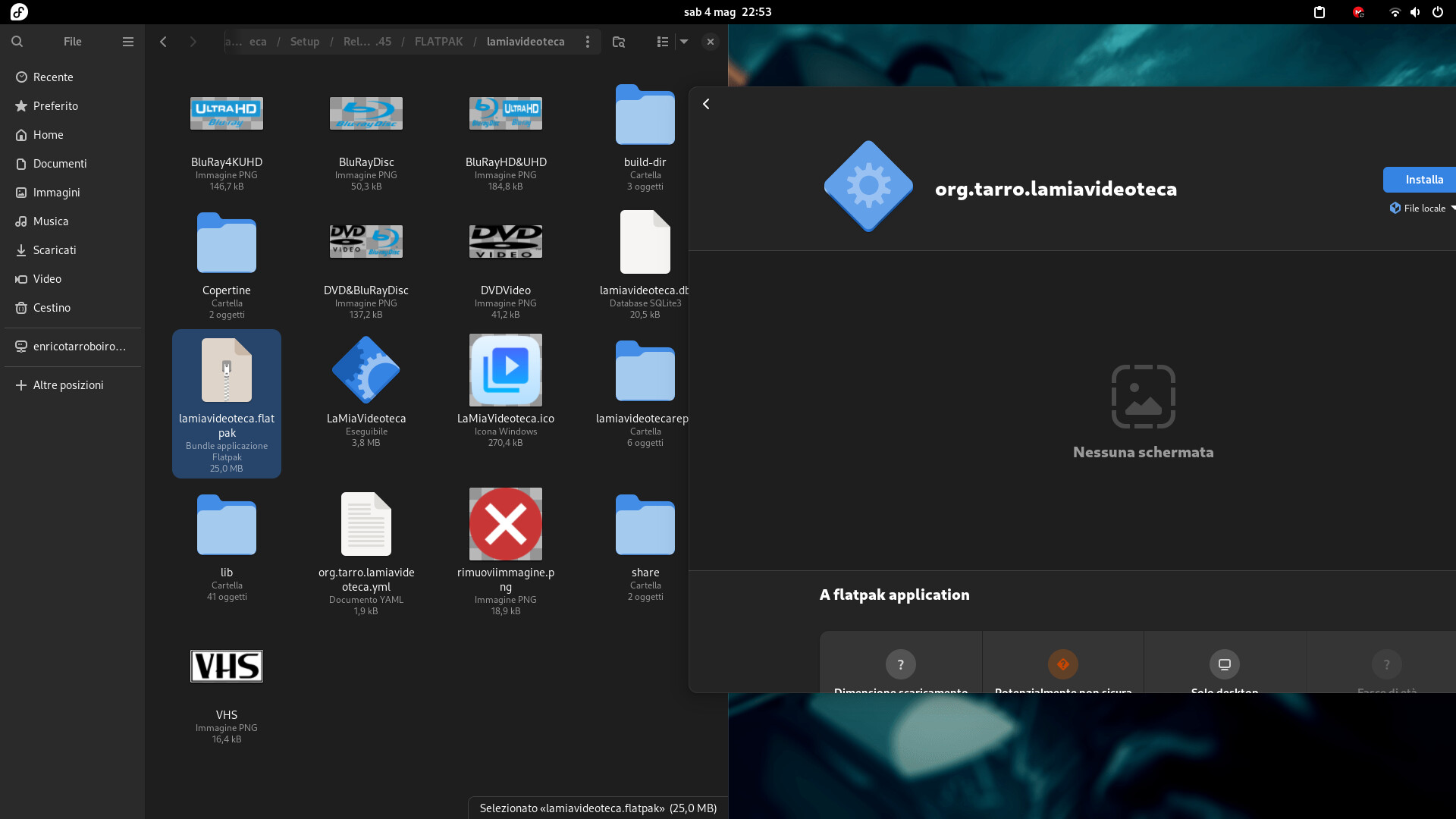

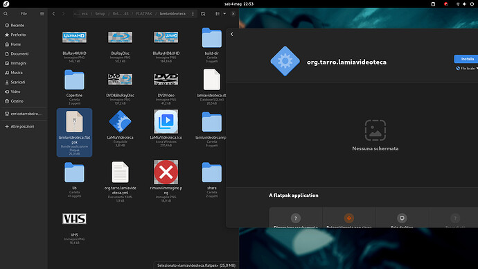

I’ll have to try it and there will probably be some problems (things like gnome integration) but I’ll look at it calmly… is it normal that the .flatpak weighs only 25 megabytes despite the build-dir weighing about 75 megabytes?

RESOLVED
For anyone who sees this post in the future, I’ll recap what I did to compile the .flatpak file.
I created a manifest file in the directory where the binaries related to my program were located which I called org.tarro.lamiavideoteca.yml, inside this file I wrote:

Still inside this directory I opened in terminal and issued these three commands:
flatpak-builder build-dir org.tarro.lamiavideoteca.yml
flatpak build-export lamiavideotecarepo build-dir stable
(this command creates a folder which is nothing other than the local repository)
flatpak build-bundle lamiavideotecarepo lamiavideoteca.flatpak org.tarro.lamiavideoteca stable
(this command actually creates the .flatpak file)
I hope the post can help someone in the future. Thanks
