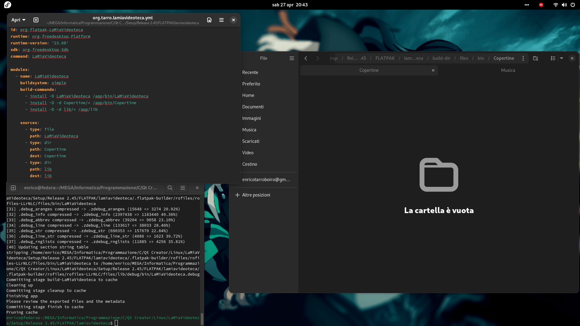

Thanks for answer. Could give me an example for dir Copertine of this code?:
runtime: org.freedesktop.Platform
runtime-version: '23.08'
sdk: org.freedesktop.Sdk
command: LaMiaVideoteca
modules:
  - name: LaMiaVideoteca
    buildsystem: simple
    build-commands:
      - install -D LaMiaVideoteca /app/bin/LaMiaVideoteca
      - install -D -d Copertine/* /app/bin/Copertine
      - install -D -d lib/* /app/lib
    sources:
      - type: file
        path: LaMiaVideoteca
      - type: dir
        path: Copertine
      - type: dir
        path: lib

Replying to #21
Should work like this:
    sources:
      - type: file
      - type: dir
        path: Copertine
        dest: Copertine
      - type: dir
        path: lib
        dest: lib
E
Replying to #22

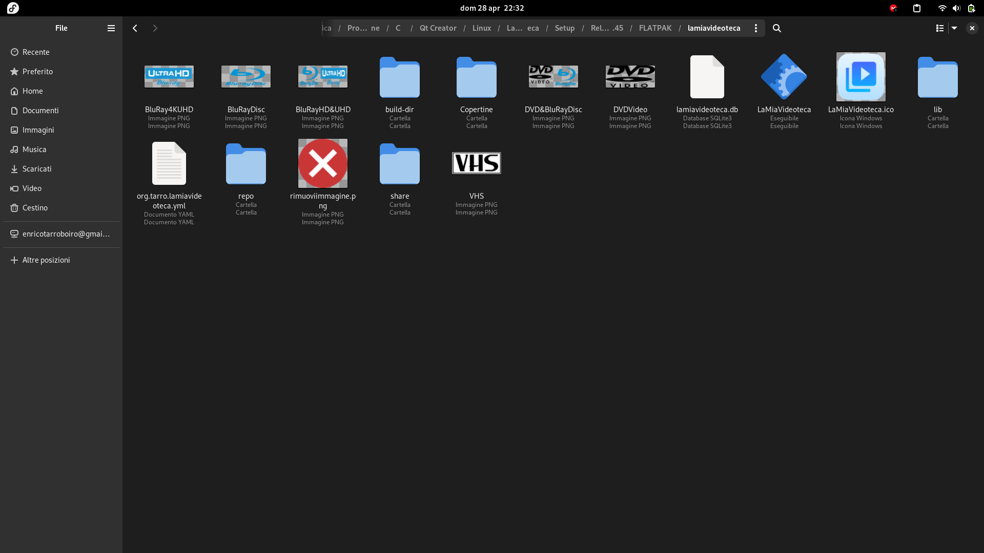

Thanks but it still doesn’t copy the files inside.
C
Replying to #23
Try cp -R (if there are subfolders) or install -D -t /app/lib/ lib/*. Your install commands don’t work.
Else, as I said, check the build folders in .flatpak-builder/build or use --build-shell, then you’ll see what is available inside the sandbox.

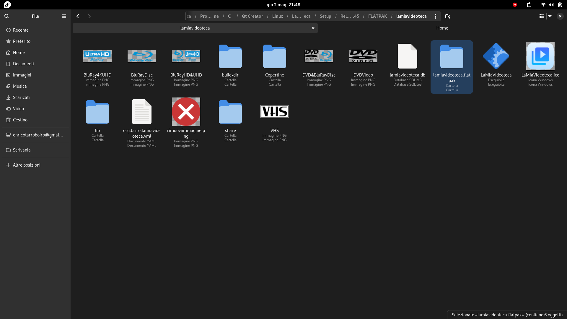

E
Replying to #24
I was able to copy all the files with this code. However, I think it is absurd to have to copy the files one by one.

      - mkdir /app/lib/x86_64-linux-gnu/qt6/plugins/egldeviceintegrations
      - mkdir /app/lib/x86_64-linux-gnu/qt6/plugins/generic
      - mkdir /app/lib/x86_64-linux-gnu/qt6/plugins/imageformats
      - mkdir /app/lib/x86_64-linux-gnu/qt6/plugins/networkinformation
      - mkdir /app/lib/x86_64-linux-gnu/qt6/plugins/platforminputcontexts
      - mkdir /app/lib/x86_64-linux-gnu/qt6/plugins/platforms
      - mkdir /app/lib/x86_64-linux-gnu/qt6/plugins/platformthemes
      - mkdir /app/lib/x86_64-linux-gnu/qt6/plugins/printsupport
      - mkdir /app/lib/x86_64-linux-gnu/qt6/plugins/sqldrivers
      - mkdir /app/lib/x86_64-linux-gnu/qt6/plugins/tls
      - mkdir /app/lib/x86_64-linux-gnu/qt6/plugins/xcbglintegrations
      - install -T ld-linux-x86-64.so.2 /app/lib/x86_64-linux-gnu/ld-linux-x86-64.so.2
      - install -T libbrotlicommon.so.1.0.9 /app/lib/x86_64-linux-gnu/libbrotlicommon.so.1.0.9
      - install -T libbrotlidec.so.1.0.9 /app/lib/x86_64-linux-gnu/libbrotlidec.so.1.0.9
      - install -T libbsd.so.0.11.7 /app/lib/x86_64-linux-gnu/libbsd.so.0.11.7
      - install -T libbz2.so.1.0.4 /app/lib/x86_64-linux-gnu/libbz2.so.1.0.4
      - install -T libc.so.6 /app/lib/x86_64-linux-gnu/libc.so.6
      - install -T libcap.so.2.66 /app/lib/x86_64-linux-gnu/libcap.so.2.66
      - install -T libdbus-1.so.3.32.4 /app/lib/x86_64-linux-gnu/libdbus-1.so.3.32.4
      - install -T libdl.so.2 /app/lib/x86_64-linux-gnu/libdl.so.2
      - install -T libdouble-conversion.so.3.1 /app/lib/x86_64-linux-gnu/libdouble-conversion.so.3.1
      - install -T libEGL.so.1.1.0 /app/lib/x86_64-linux-gnu/libEGL.so.1.1.0
      - install -T libexpat.so.1.8.10 /app/lib/x86_64-linux-gnu/libexpat.so.1.8.10
      - install -T libfontconfig.so.1.12.0 /app/lib/x86_64-linux-gnu/libfontconfig.so.1.12.0
      - install -T libfreetype.so.6.20.0  /app/lib/x86_64-linux-gnu/libfreetype.so.6.20.0
      - install -T libgcc_s.so.1  /app/lib/x86_64-linux-gnu/libgcc_s.so.1
      - install -T libgcrypt.so.20.4.2 /app/lib/x86_64-linux-gnu/libgcrypt.so.20.4.2
      - install -T libGL.so.1.7.0 /app/lib/x86_64-linux-gnu/libGL.so.1.7.0
      - install -T libGLdispatch.so.0.0.0 /app/lib/x86_64-linux-gnu/libGLdispatch.so.0.0.0
      - install -T libglib-2.0.so.0.7800.0 /app/lib/x86_64-linux-gnu/libglib-2.0.so.0.7800.0
      - install -T libGLX.so.0.0.0 /app/lib/x86_64-linux-gnu/libGLX.so.0.0.0
      - install -T libgthread-2.0.so.0.7800.0 /app/lib/x86_64-linux-gnu/libgthread-2.0.so.0.7800.0
      - install -T libgtk3-nocsd.so.0 /app/lib/x86_64-linux-gnu/libgtk3-nocsd.so.0
      - install -T libicudata.so.56.1 /app/lib/x86_64-linux-gnu/libicudata.so.56.1
      - install -T libicudata.so.72.1 /app/lib/x86_64-linux-gnu/libicudata.so.72.1
      - install -T libicui18n.so.56.1 /app/lib/x86_64-linux-gnu/libicui18n.so.56.1
      - install -T libicuuc.so.56.1 /app/lib/x86_64-linux-gnu/libicuuc.so.56.1
      - install -T libicuuc.so.72.1 /app/lib/x86_64-linux-gnu/libicuuc.so.72.1
      - install -T liblz4.so.1.9.4 /app/lib/x86_64-linux-gnu/liblz4.so.1.9.4
      - install -T liblzma.so.5.4.1 /app/lib/x86_64-linux-gnu/liblzma.so.5.4.1
      - install -T libm.so  /app/lib/x86_64-linux-gnu/libm.so
      - install -T libm.so.6 /app/lib/x86_64-linux-gnu/libm.so.6
      - install -T libmd.so.0.1.0  /app/lib/x86_64-linux-gnu/libmd.so.0.1.0
      - install -T libmd4c.so.0.4.8 /app/lib/x86_64-linux-gnu/libmd4c.so.0.4.8
      - install -T libpcre2-8.so.0.11.2 /app/lib/x86_64-linux-gnu/libpcre2-8.so.0.11.2
      - install -T libpng16.so.16.40.0 /app/lib/x86_64-linux-gnu/libpng16.so.16.40.0
      - install -T libpthread.so.0 /app/lib/x86_64-linux-gnu/libpthread.so.0
      - install -T libQt6Core.so.6.6.2  /app/lib/x86_64-linux-gnu/libQt6Core.so.6.6.2
      - install -T libQt6DBus.so.6.6.2 /app/lib/x86_64-linux-gnu/libQt6DBus.so.6.6.2
      - install -T libQt6EglFSDeviceIntegration.so.6.6.2 /app/lib/x86_64-linux-gnu/libQt6EglFSDeviceIntegration.so.6.6.2
      - install -T libQt6EglFsKmsSupport.so.6.6.2 /app/lib/x86_64-linux-gnu/libQt6EglFsKmsSupport.so.6.6.2
      - install -T libQt6Gui.so.6.6.2 /app/lib/x86_64-linux-gnu/libQt6Gui.so.6.6.2
      - install -T libQt6Sql.so.6.6.2 /app/lib/x86_64-linux-gnu/libQt6Sql.so.6.6.2
      - install -T libQt6Widgets.so.6.6.2 /app/lib/x86_64-linux-gnu/libQt6Widgets.so.6.6.2
      - install -T libQt6XcbQpa.so.6.6.2 /app/lib/x86_64-linux-gnu/libQt6XcbQpa.so.6.6.2
      - install -T librt.so.1 /app/lib/x86_64-linux-gnu/librt.so.1
      - install -T libstdc++.so.6.0.32 /app/lib/x86_64-linux-gnu/libstdc++.so.6.0.32
      - install -T libsystemd.so.0.36.0 /app/lib/x86_64-linux-gnu/libsystemd.so.0.36.0
      - install -T libX11.so.6.4.0  /app/lib/x86_64-linux-gnu/libX11.so.6.4.0
      - install -T libXau.so.6.0.0  /app/lib/x86_64-linux-gnu/libXau.so.6.0.0
      - install -T libxcb.so.1.1.0 /app/lib/x86_64-linux-gnu/libxcb.so.1.1.0
      - install -T libXdmcp.so.6.0.0 /app/lib/x86_64-linux-gnu/libXdmcp.so.6.0.0
      - install -T libxkbcommon.so.0.0.0  /app/lib/x86_64-linux-gnu/libxkbcommon.so.0.0.0
      - install -T libz.so.1.2.13 /app/lib/x86_64-linux-gnu/libz.so.1.2.13
      - install -T libzstd.so.1.5.5  /app/lib/x86_64-linux-gnu/libzstd.so.1.5.5
      - install -T libqquickwidget.so /app/lib/x86_64-linux-gnu/qt6/plugins/designer/libqquickwidget.so
      - install -T libqeglfs-emu-integration.so /app/lib/x86_64-linux-gnu/qt6/plugins/egldeviceintegrations/libqeglfs-emu-integration.so
      - install -T libqeglfs-kms-egldevice-integration.so  /app/lib/x86_64-linux-gnu/qt6/plugins/egldeviceintegrations/libqeglfs-kms-egldevice-integration.so
      - install -T libqeglfs-kms-integration.so  /app/lib/x86_64-linux-gnu/qt6/plugins/egldeviceintegrations/libqeglfs-kms-integration.so
      - install -T libqeglfs-x11-integration.so  /app/lib/x86_64-linux-gnu/qt6/plugins/egldeviceintegrations/libqeglfs-x11-integration.so
      - install -T libqevdevkeyboardplugin.so  /app/lib/x86_64-linux-gnu/qt6/plugins/generic/libqevdevkeyboardplugin.so
      - install -T libqevdevmouseplugin.so  /app/lib/x86_64-linux-gnu/qt6/plugins/generic/libqevdevmouseplugin.so
      - install -T libqevdevtabletplugin.so /app/lib/x86_64-linux-gnu/qt6/plugins/generic/libqevdevtabletplugin.so
      - install -T libqevdevtouchplugin.so /app/lib/x86_64-linux-gnu/qt6/plugins/generic/libqevdevtouchplugin.so
      - install -T libqlibinputplugin.so /app/lib/x86_64-linux-gnu/qt6/plugins/generic/libqlibinputplugin.so
      - install -T libqtslibplugin.so /app/lib/x86_64-linux-gnu/qt6/plugins/generic/libqtslibplugin.so
      - install -T libqtuiotouchplugin.so /app/lib/x86_64-linux-gnu/qt6/plugins/generic/libqtuiotouchplugin.so
      - install -T libqgif.so /app/lib/x86_64-linux-gnu/qt6/plugins/imageformats/libqgif.so
      - install -T libqico.so /app/lib/x86_64-linux-gnu/qt6/plugins/imageformats/libqico.so
      - install -T libqjpeg.so  /app/lib/x86_64-linux-gnu/qt6/plugins/imageformats/libqjpeg.so
      - install -T libqnetworkmanager.so /app/lib/x86_64-linux-gnu/qt6/plugins/networkinformation/libqnetworkmanager.so
      - install -T libcomposeplatforminputcontextplugin.so /app/lib/x86_64-linux-gnu/qt6/plugins/platforminputcontexts/libcomposeplatforminputcontextplugin.so
      - install -T libibusplatforminputcontextplugin.so /app/lib/x86_64-linux-gnu/qt6/plugins/platforminputcontexts/libibusplatforminputcontextplugin.so
      - install -T libqeglfs.so /app/lib/x86_64-linux-gnu/qt6/plugins/platforms/libqeglfs.so
      - install -T libqlinuxfb.so /app/lib/x86_64-linux-gnu/qt6/plugins/platforms/libqlinuxfb.so
      - install -T libqminimal.so /app/lib/x86_64-linux-gnu/qt6/plugins/platforms/libqminimal.so
      - install -T libqminimalegl.so /app/lib/x86_64-linux-gnu/qt6/plugins/platforms/libqminimalegl.so
      - install -T libqoffscreen.so /app/lib/x86_64-linux-gnu/qt6/plugins/platforms/libqoffscreen.so
      - install -T libqvkkhrdisplay.so /app/lib/x86_64-linux-gnu/qt6/plugins/platforms/libqvkkhrdisplay.so
      - install -T libqvnc.so /app/lib/x86_64-linux-gnu/qt6/plugins/platforms/libqvnc.so
      - install -T libqxcb.so /app/lib/x86_64-linux-gnu/qt6/plugins/platforms/libqxcb.so
      - install -T libqgtk3.so  /app/lib/x86_64-linux-gnu/qt6/plugins/platformthemes/libqgtk3.so
      - install -T libcupsprintersupport.so /app/lib/x86_64-linux-gnu/qt6/plugins/printsupport/libcupsprintersupport.so
      - install -T libqsqlite.so  /app/lib/x86_64-linux-gnu/qt6/plugins/sqldrivers/libqsqlite.so
      - install -T libqcertonlybackend.so /app/lib/x86_64-linux-gnu/qt6/plugins/tls/libqcertonlybackend.so
      - install -T libqopensslbackend.so /app/lib/x86_64-linux-gnu/qt6/plugins/tls/libqopensslbackend.so
      - install -T libqxcb-egl-integration.so /app/lib/x86_64-linux-gnu/qt6/plugins/xcbglintegrations/libqxcb-egl-integration.so
      - install -T libqxcb-glx-integration.so /app/lib/x86_64-linux-gnu/qt6/plugins/xcbglintegrations/libqxcb-glx-integration.so
      - ln -s libbrotlicommon.so.1.0.9 /app/lib/x86_64-linux-gnu/libbrotlicommon.so
      - ln -s libbrotlicommon.so.1.0.9  /app/lib/x86_64-linux-gnu/libbrotlicommon.so.1
      - ln -s libbrotlidec.so.1.0.9  /app/lib/x86_64-linux-gnu/libbrotlidec.so
      - ln -s libbrotlidec.so.1.0.9  /app/lib/x86_64-linux-gnu/libbrotlidec.so.1
      - ln -s libbsd.so.0.11.7 /app/lib/x86_64-linux-gnu/libbsd.so.0
      - ln -s libbz2.so.1.0.4 /app/lib/x86_64-linux-gnu/libbz2.so
      - ln -s libbz2.so.1.0.4 /app/lib/x86_64-linux-gnu/libbz2.so.1
      - ln -s libbz2.so.1.0.4 /app/lib/x86_64-linux-gnu/libbz2.so.1.0
      - ln -s libcap.so.2.66  /app/lib/x86_64-linux-gnu/libcap.so.2
      - ln -s libdbus-1.so.3.32.4 /app/lib/x86_64-linux-gnu/libdbus-1.so.3
      - ln -s libdouble-conversion.so.3.1 /app/lib/x86_64-linux-gnu/libdouble-conversion.so.3
      - ln -s  libEGL.so.1.1.0 /app/lib/x86_64-linux-gnu/libEGL.so.1
      - ln -s libexpat.so.1.8.10 /app/lib/x86_64-linux-gnu/libexpat.so
      - ln -s libfontconfig.so.1.12.0  /app/lib/x86_64-linux-gnu/libfontconfig.so.1
      - ln -s libfreetype.so.6.20.0 /app/lib/x86_64-linux-gnu/libfreetype.so
      - ln -s libfreetype.so.6.20.0 /app/lib/x86_64-linux-gnu/libfreetype.so.6
      - ln -s libgcrypt.so.20.4.2 /app/lib/x86_64-linux-gnu/libgcrypt.so.20
      - ln -s libGL.so.1.7.0 /app/lib/x86_64-linux-gnu/libGL.so.1
      - ln -s libGLdispatch.so.0.0.0  /app/lib/x86_64-linux-gnu/libGLdispatch.so
      - ln -s libGLdispatch.so.0.0.0 /app/lib/x86_64-linux-gnu/libGLdispatch.so.0
      - ln -s libglib-2.0.so.0.7800.0 /app/lib/x86_64-linux-gnu/libglib-2.0.so
      - ln -s libglib-2.0.so.0.7800.0 /app/lib/x86_64-linux-gnu/libglib-2.0.so.0
      - ln -s libGLX.so.0.0.0 /app/lib/x86_64-linux-gnu/libGLX.so
      - ln -s libGLX.so.0.0.0 /app/lib/x86_64-linux-gnu/libGLX.so.0
      - ln -s libgthread-2.0.so.0.7800.0 /app/lib/x86_64-linux-gnu/libgthread-2.0.so
      - ln -s libgthread-2.0.so.0.7800.0 /app/lib/x86_64-linux-gnu/libgthread-2.0.so.0
      - ln -s libicudata.so.56.1 /app/lib/x86_64-linux-gnu/libicudata.so
      - ln -s libicudata.so.72.1  /app/lib/x86_64-linux-gnu/libicudata.so.72
      - ln -s libicui18n.so.56.1 /app/lib/x86_64-linux-gnu/libicui18n.so
      - ln -s libicui18n.so.56.1 /app/lib/x86_64-linux-gnu/libicui18n.so.72
      - ln -s libicuuc.so.56.1  /app/lib/x86_64-linux-gnu/libicuuc.so
      - ln -s libicuuc.so.72.1 /app/lib/x86_64-linux-gnu/libicuuc.so.72
      - ln -s liblz4.so.1.9.4 /app/lib/x86_64-linux-gnu/liblz4.so.1
      - ln -s liblzma.so.5.4.1  /app/lib/x86_64-linux-gnu/liblzma.so.5
      - ln -s libmd.so.0.1.0  /app/lib/x86_64-linux-gnu/libmd.so.0
      - ln -s libmd4c.so.0.4.8  /app/lib/x86_64-linux-gnu/libmd4c.so.0
      - ln -s libpcre2-8.so.0.11.2 /app/lib/x86_64-linux-gnu/libpcre2-8.so
      - ln -s libpcre2-8.so.0.11.2  /app/lib/x86_64-linux-gnu/libpcre2-8.so.0
      - ln -s libpng16.so.16.40.0 /app/lib/x86_64-linux-gnu/libpng16.so.16
      - ln -s libQt6Core.so.6.6.2 /app/lib/x86_64-linux-gnu/libQt6Core.so
      - ln -s libQt6Core.so.6.6.2 /app/lib/x86_64-linux-gnu/libQt6Core.so.6
      - ln -s libQt6DBus.so.6.6.2 /app/lib/x86_64-linux-gnu/libQt6DBus.so
      - ln -s libQt6DBus.so.6.6.2 /app/lib/x86_64-linux-gnu/libQt6DBus.so.6
      - ln -s libQt6EglFSDeviceIntegration.so.6.6.2 /app/lib/x86_64-linux-gnu/libQt6EglFSDeviceIntegration.so
      - ln -s libQt6EglFSDeviceIntegration.so.6.6.2  /app/lib/x86_64-linux-gnu/libQt6EglFSDeviceIntegration.so.6
      - ln -s libQt6EglFsKmsSupport.so.6.6.2 /app/lib/x86_64-linux-gnu/libQt6EglFsKmsSupport.so
      - ln -s libQt6EglFsKmsSupport.so.6.6.2  /app/lib/x86_64-linux-gnu/libQt6EglFsKmsSupport.so.6
      - ln -s libQt6Gui.so.6.6.2 /app/lib/x86_64-linux-gnu/libQt6Gui.so
      - ln -s libQt6Gui.so.6.6.2 /app/lib/x86_64-linux-gnu/libQt6Gui.so.6
      - ln -s libQt6Sql.so.6.6.2 /app/lib/x86_64-linux-gnu/libQt6Sql.so
      - ln -s libQt6Sql.so.6.6.2 /app/lib/x86_64-linux-gnu/libQt6Sql.so.6
      - ln -s libQt6Widgets.so.6.6.2 /app/lib/x86_64-linux-gnu/libQt6Widgets.so
      - ln -s libQt6Widgets.so.6.6.2 /app/lib/x86_64-linux-gnu/libQt6Widgets.so.6
      - ln -s libQt6XcbQpa.so.6.6.2 /app/lib/x86_64-linux-gnu/libQt6XcbQpa.so
      - ln -s libQt6XcbQpa.so.6.6.2 /app/lib/x86_64-linux-gnu/libQt6XcbQpa.so.6
      - ln -s libstdc++.so.6.0.32 /app/lib/x86_64-linux-gnu/libstdc++.so.6
      - ln -s libsystemd.so.0.36.0 /app/lib/x86_64-linux-gnu/libsystemd.so.0
      - ln -s libX11.so.6.4.0 /app/lib/x86_64-linux-gnu/libX11.so.6
      - ln -s libXau.so.6.0.0  /app/lib/x86_64-linux-gnu/libXau.so
      - ln -s libXau.so.6.0.0  /app/lib/x86_64-linux-gnu/libXau.so.6
      - ln -s libxcb.so.1.1.0  /app/lib/x86_64-linux-gnu/libxcb.so
      - ln -s libxcb.so.1.1.0  /app/lib/x86_64-linux-gnu/libxcb.so.1
      - ln -s libXdmcp.so.6.0.0  /app/lib/x86_64-linux-gnu/libXdmcp.so
      - ln -s libXdmcp.so.6.0.0 /app/lib/x86_64-linux-gnu/libXdmcp.so.6
      - ln -s libxkbcommon.so.0.0.0 /app/lib/x86_64-linux-gnu/libxkbcommon.so.0
      - ln -s libz.so.1.2.13 /app/lib/x86_64-linux-gnu/libz.so
      - ln -s libz.so.1.2.13  /app/lib/x86_64-linux-gnu/libz.so.1
      - ln -s libzstd.so.1.5.5  /app/lib/x86_64-linux-gnu/libzstd.so.1
Now I just need to find a way to generate the .flatpak
C
Replying to #25

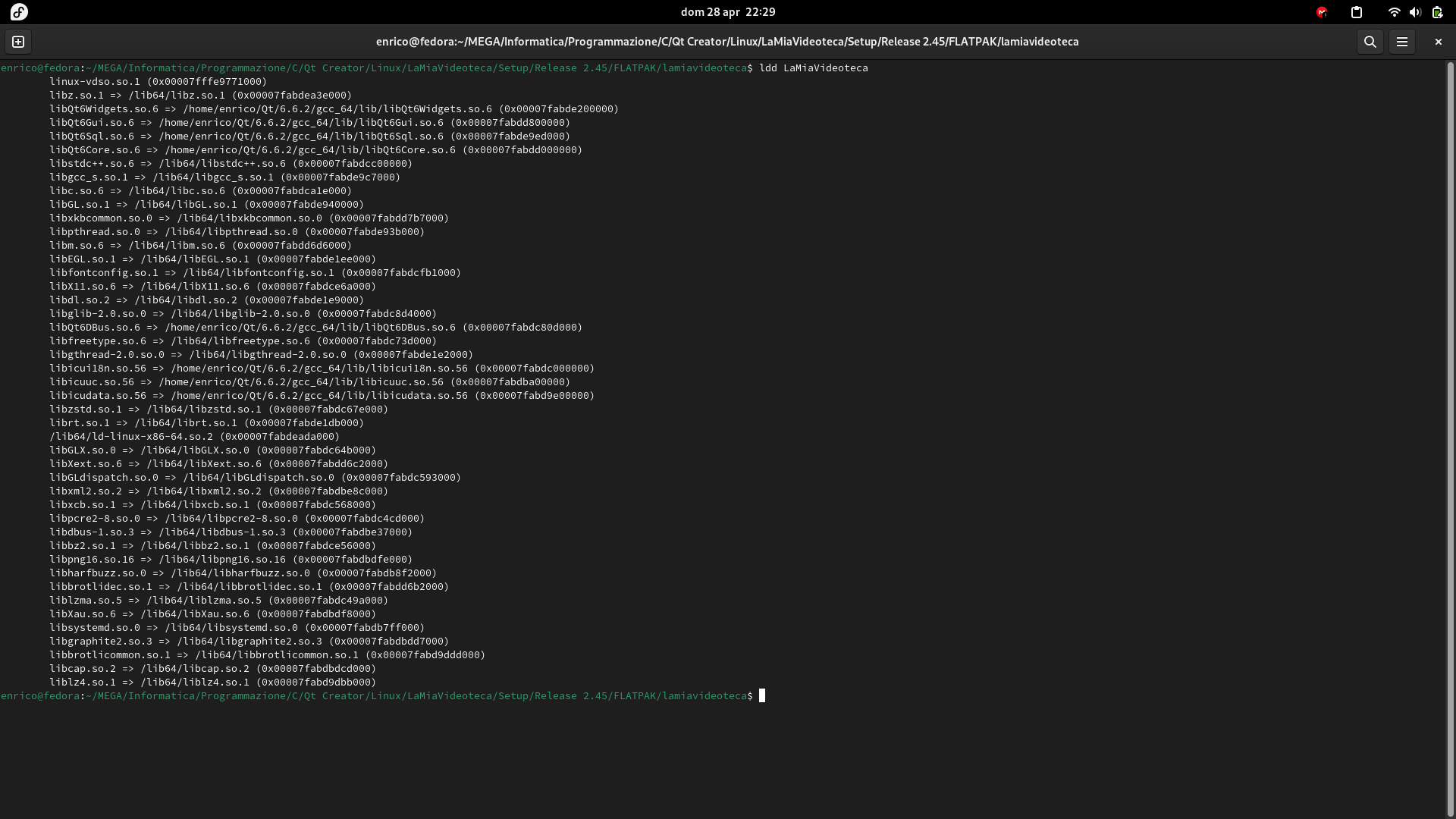

You don’t have to. Just use a command which actually works, we have provided two solutions.
In general: Don’t copy all the libraries. Use what’s provided by the runtimes. Since you seem to require Qt6, you can use org.kde.Platform & org.kde.Sdk (current version 6.7).
You make your application much bigger than necessary & are now responsible to maintain a whole distribution inside your application to keep it secure.
And don’t use org.flatpak.LaMiaVideoteca as id. Use your own URL (I guess org.torro.LaMiaVideoteca). The id identifies the developer & the application, not the distribution method.

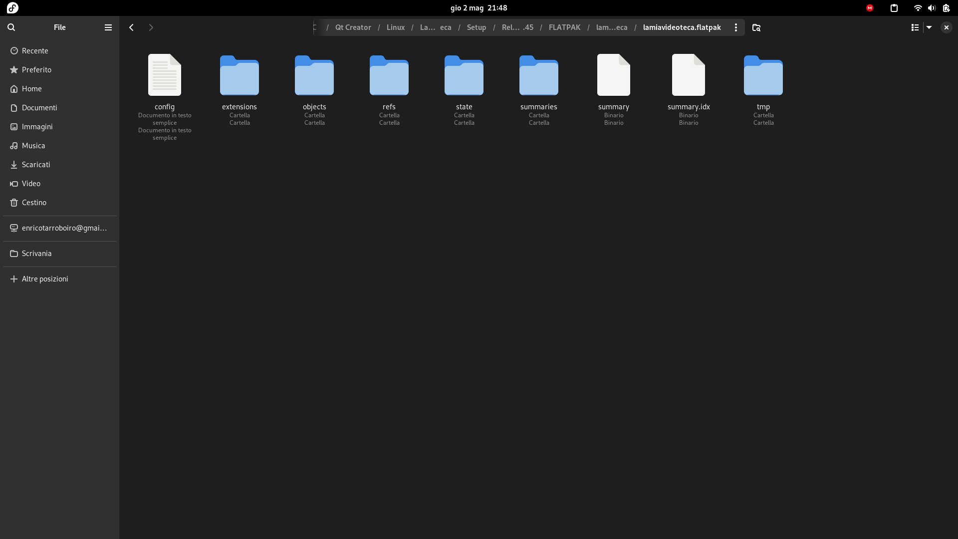

You have to create a local repository & then you can use flatpak build-bundle to create a .flatpak from it. See the documentation I’ve linked.
You should read the Flatpak documentation anyway because you haven’t set any finish-args. Currently your app is not allowed to access anything, it’s not even allowed to display the GUI.

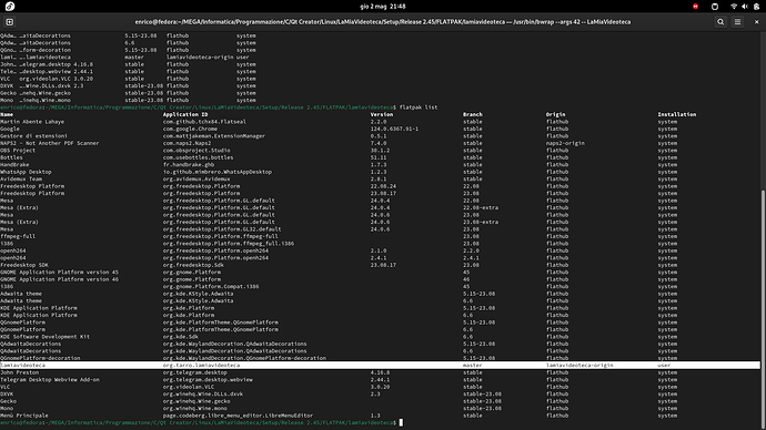

Ok… Thanks… I change in this way:

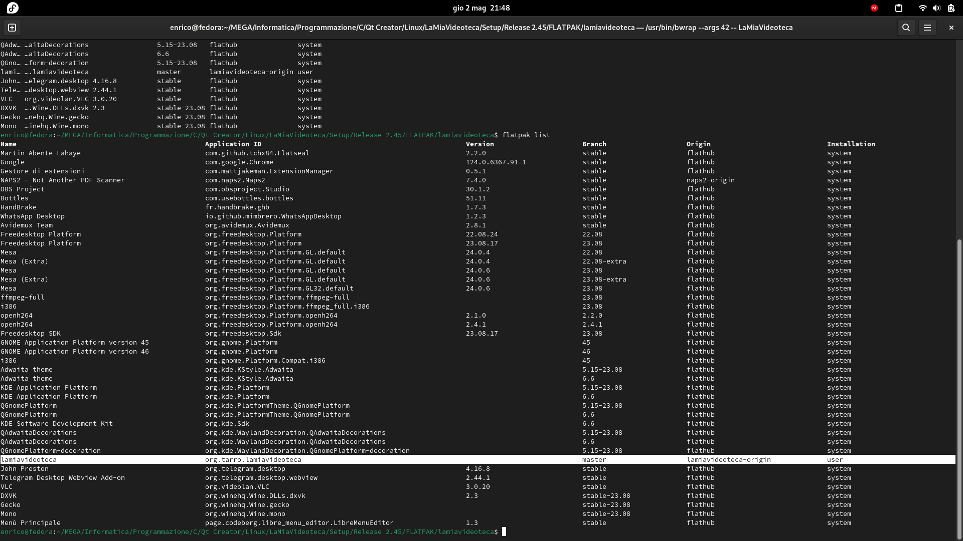

I compiled everything with this command flatpak-builder --repo=repo build-dir org.tarro.lamiavideoteca.yml (I should have created the repo which I simply called repo)
Now I look this: https://docs.flatpak.org/en/latest/single-file-bundles.html
And I tried this command flatpak build-bundle lamiavideoteca.flatpak org.tarro.lamiavideoteca but not works.
Furthermore, as regards the libraries, I used the ldd command on the executable that I wrote to obtain the libraries necessary for its operation and I then took them. I would like to know if the method I used is by chance wrong, since you told me I also put some unnecessary libs. Thanks

The method is ok. But you don’t want to copy all the libraries from your system. You should remove all libs & then execute ldd from within the Flatpak sandbox (see flatpak-builder --run). Then only a few libraries should be missing. The list should become even shorter if you switch to org.kde.Platform.
If possible, you would then build the missing dependencies from source (see the Flatpak documentation & the existing manifests at Flathub · GitHub).

Thank you for answering me. So I deleted all the libraries and changed my manifest like this:
runtime: org.kde.Platform
runtime-version: '6.6'
sdk: org.kde.Sdk
modules:
    buildsystem: simple
    sources:
      - type: file
      - type: file
        path: BluRay4KUHD
      - type: file
        path: BluRayDisc
      - type: file
        path: 'BluRayHD&UHD'
      - type: file
        path: 'DVD&BluRayDisc'
      - type: file
        path: DVDVideo
      - type: file
        path: LaMiaVideoteca.ico
      - type: file
        path: rimuoviimmagine.png
      - type: file
        path: VHS
      - type: file
        path: lamiavideoteca.db
      - type: file
        path: Copertine/Supporto Cassetta/1
      - type: file
        path: Copertine/Supporto Cassetta/2
      - type: file
        path: Copertine/Supporto Cassetta/3
      - type: file
        path: Copertine/Supporto Cassetta/Nessuna Immagine Disponibile
      - type: file
        path: share/applications/org.tarro.lamiavideoteca.desktop
      - type: file
        path: share/icons/org.tarro.lamiavideoteca.ico
    build-commands:
      - mkdir /app/bin/Copertine
      - mkdir /app/bin/Copertine/'Supporto Cassetta'
      - mkdir /app/bin/Copertine/'Supporto Disco'
      - mkdir /app/share
      - mkdir /app/share/applications
      - mkdir /app/share/icons
      - install -T BluRay4KUHD /app/bin/BluRay4KUHD
      - install -T BluRayDisc /app/bin/BluRayDisc
      - install -T 'BluRayHD&UHD' /app/bin/'BluRayHD&UHD'
      - install -T 'DVD&BluRayDisc' /app/bin/'DVD&BluRayDisc'
      - install -T DVDVideo /app/bin/DVDVideo
      - install -T LaMiaVideoteca.ico /app/bin/LaMiaVideoteca.ico
      - install -T rimuoviimmagine.png /app/bin/rimuoviimmagine.png
      - install -T VHS /app/bin/VHS
      - install -T lamiavideoteca.db /app/bin/lamiavideoteca.db
      - install -T 'Nessuna Immagine Disponibile' /app/bin/Copertine/'Supporto Cassetta'/'Nessuna Immagine Disponibile'
      - install -T 1 /app/bin/Copertine/'Supporto Cassetta'/1
      - install -T 2 /app/bin/Copertine/'Supporto Cassetta'/2
      - install -T 3 /app/bin/Copertine/'Supporto Cassetta'/3
      - install -T org.tarro.lamiavideoteca.desktop /app/share/applications/org.tarro.lamiavideoteca.desktop
      - install -T org.tarro.lamiavideoteca.ico /app/share/icons/org.tarro.lamiavideoteca.ico
  - name: LaMiaVideotecaDisco
    buildsystem: simple
    sources:
      - type: file
        path: Copertine/Supporto Disco/1
      - type: file
        path: Copertine/Supporto Disco/2
      - type: file
        path: Copertine/Supporto Disco/3
      - type: file
        path: Copertine/Supporto Disco/Nessuna Immagine Disponibile
    build-commands:
      - install -T 'Nessuna Immagine Disponibile' /app/bin/Copertine/'Supporto Disco'/'Nessuna Immagine Disponibile'
      - install -T 1 /app/bin/Copertine/'Supporto Disco'/1
      - install -T 2 /app/bin/Copertine/'Supporto Disco'/2
      - install -T 3 /app/bin/Copertine/'Supporto Disco'/3
finish-args:
  # X11 + XShm access
  - --share=ipc
  - --socket=x11
  - --socket=fallback-x11
  # Wayland access
  - --socket=wayland
  # GPU acceleration if needed
  - --device=dri
  # Needs to save files locally
  - --filesystem=host

Okay. I was able to copy the folder this way:
sdk: org.kde.Sdk
modules:
    buildsystem: simple
    sources:
      - type: file
      - type: file
        path: BluRay4KUHD
      - type: file

So I’m getting closer and closer to the solution:

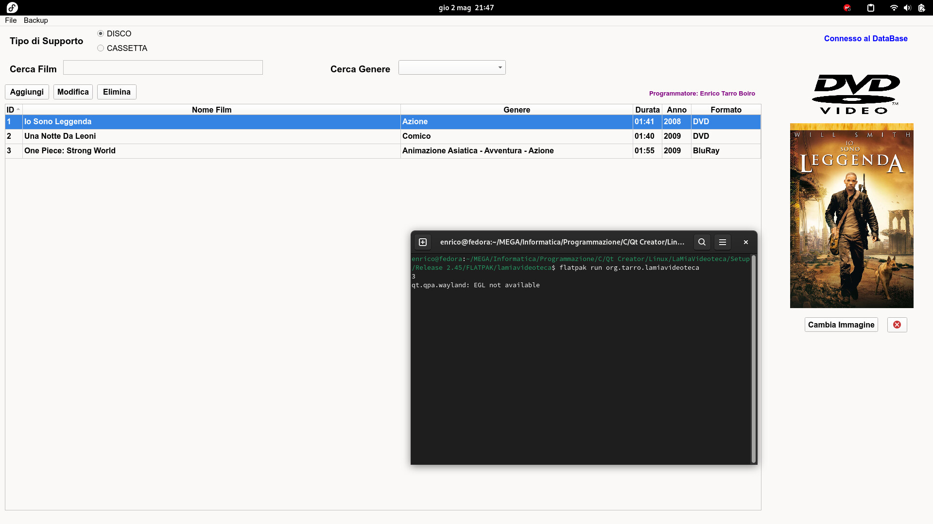

I installed my application on the PC through the command:
flatpak-builder build-dir org.tarro.lamiavideoteca.yml --install --user
Or then checked that the program started (I noticed that there is no integration as shown in the first figure):
flatpak run org.tarro.lamiavideoteca
I further verified that my application was installed figure 2.
Then I tried to generate the flatpak with the command:
flatpak build-export lamiavideoteca.flatpak build-dir org.tarro.lamiavideoteca
What I got was a .flatpak folder as shown in figure 3a and 3b. I think I am now very close to the solution. I need to figure out why it’s not a package (archive) in .flatpak and “fix” the problem. Obviously I will then have to test the package.
