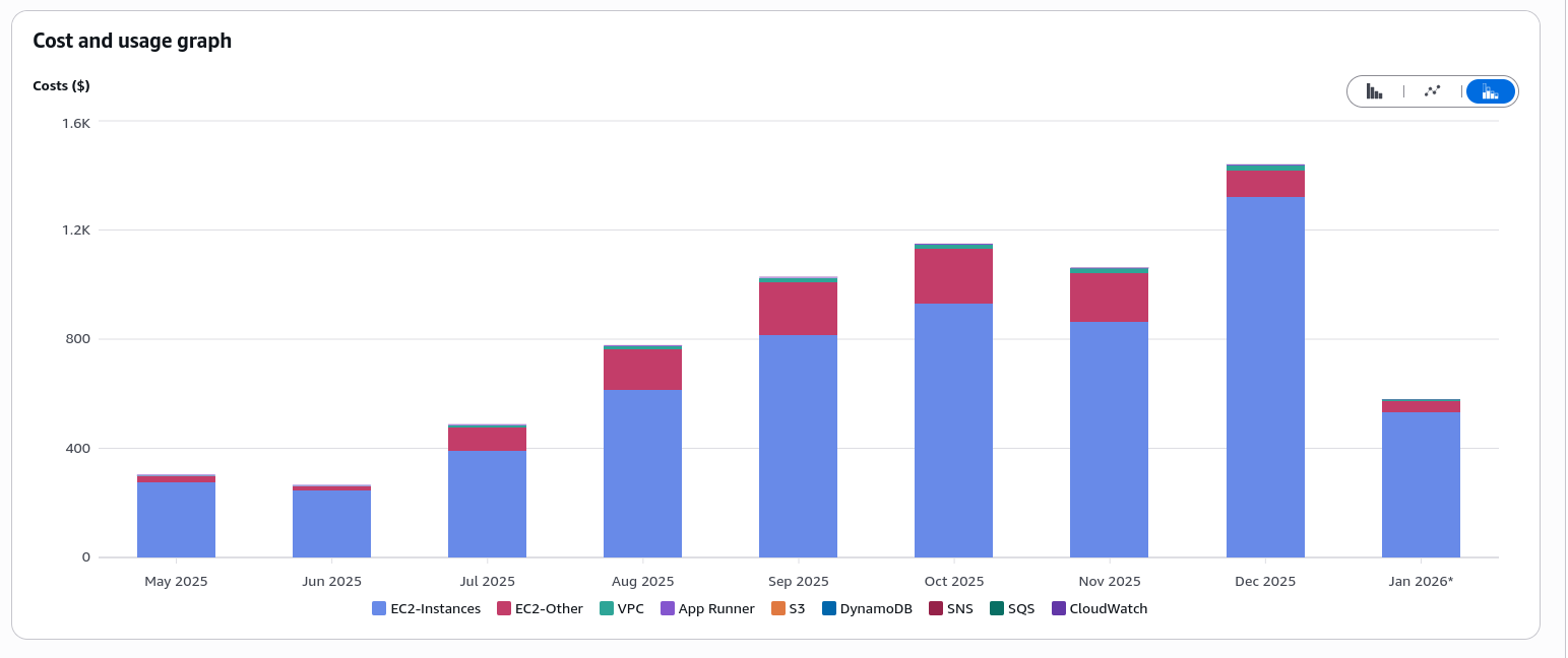

The cost breakdown since May 2025 is as follows:
Once again, we are not actually paying for anything thanks to the AWS credits for open source projects program. Thank you RunsOn team and AWS for making this possible!
