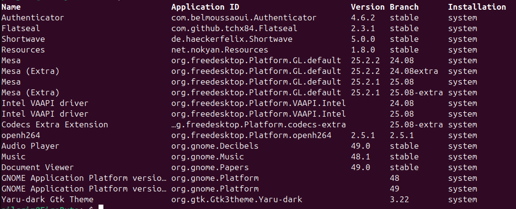

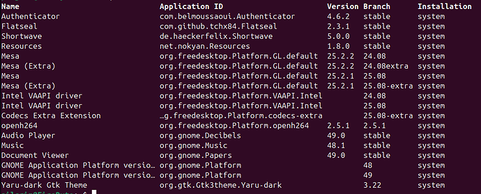

It is okay for gnome 48 base flatpak app. Here is the flatpak install app list. I have tried all options given in this discussion Flatpak Cursor Size but nothing seems to work.
